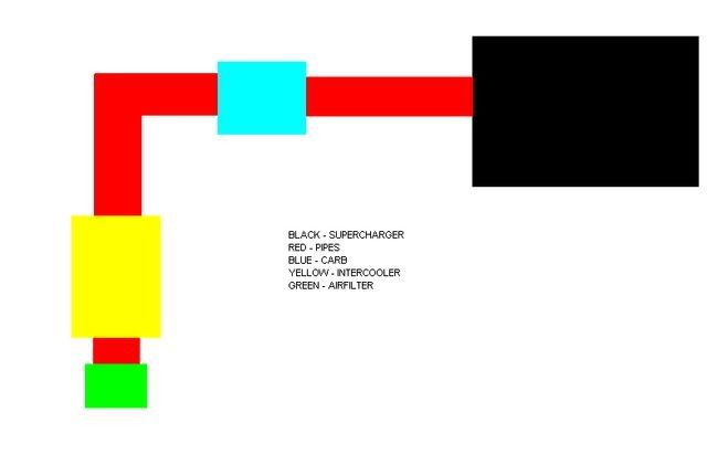

admire my excellent picture.... is it worth having intercooler?
194 Posts Member #: 1296 Advanced Member Milford Haven Pembrokeshire |
18th Apr, 2007 at 07:47:46am
your not cooling anything by putting the cooler before you've compressed the air |

the cooler will only work if between the charger and engine.

arent there three designs of super charger install, one of which you can intercoolise the compressed air |
![]() 2500 Posts Member #: 648 Post Whore Northern Ireland (ex AUS) |
18th Apr, 2007 at 09:21:20am
With a blow through set up yes- blower, intercooler then carb. On 7th Nov, 2008 Nic said:

so, suck through = get water injection for a few extra PSI of boost

On 18th of Apr, 2007 at 11:08am Turbo Shed said:
blow through = get an intercooler or charge cooler and run quite a few more PSI sorry, bit simple here, so in what order would the bits need to go to make it a blow thru? |

The compressor and then the carb, so it blows through the carb. If you have the carb before the compressor it sucks through, and since most compressors are centrifugal and you're feeding a fuel/air mix in this set up there can be problems with the fuel literally centrifuging out of the air. De-atomising maybe There is no sense crying over every mistake- you just keep on trying til you run out of cake. |

if you have a suck thruogh -carb - charger - cooler - engine, your basically sitting on a fuel bomb!! it will pool in the cooler, the only way to intercool is to have blow through
