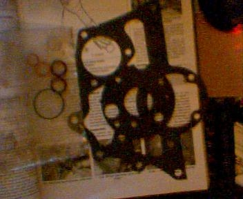

Anyone no where these parts are for and could anyone tell me what else is needed when putting gear box to engine apart from half moon seal for crank o ring seal in top of gear box and gaskget??? thanks a millon

Should this post have a picture, or isn't it supposed to make sense?

Have a go at this....
Edit : those gaskets go on the timing chain back plate and the oil pump, can't make out the others.

http://www.turbominis.co.uk/forums/attachments/150541-1.bmp

there you are

The big one is behind the timing plate
The round one is the oil pump

anyone no where the copper and fibre washers go scared going to miss something between the gearbox and engine they have gave me three gaskets for this to confuse me more

Yes they always do that with the gaskets, just use the one that fits the best.
Don't trap or damage the seals and gaskets while fitting together. I find putting the box on the engine easier.

The copper washer could well be for the sump plug

really small and some of them are fibre is there any more than one to be put on the top of the gear box or the under side of the engine looks like there could be at each end but not sure cheers

Nope. One black o ring, 2 gaskets and 1 half moon seal *wink*
Dowels in the bigger holes?

be careful when your selecting the gasket for the timing chain back plate (the bigger gasket in you picture) as there is a few different types and if you use the wrong one it leaks oil ( been there,lol) check it on the block first.
make sure you remeber the o ring for the oil pick up on your gear box. there is a hole on the top of your gearbox to engine mounting face, this needs a o ring.
p.s get a haynes manual if youve not got one already, if you have got one read it! lol

i think they just put them fibre and copper washers in there to confuse you, i've not found a use for them yet.
