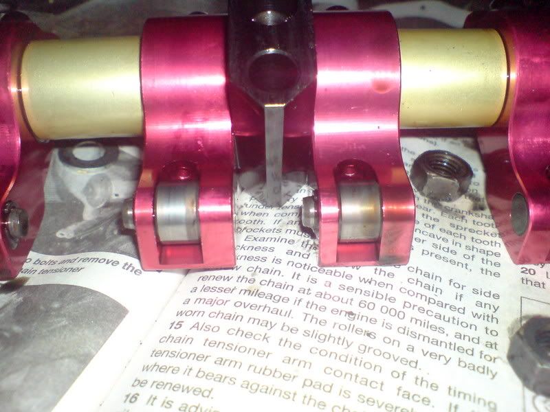

You should choose the rocker ratio to suit the engine build spec.
The original question of are roller rockers necessary has to be answered no IMHO.
Roller tipped rockers do have a little benefit, well so some will say. The problem I have with this that there is little to encourage the roller tip to actually do a full rotation so they do wear eventually and stop rolling.
Using roller bearings on the shaft seems totally crazy to me. If I was going to choose a bearing medium for a rocker about as far down the list as I'd be bothered to look I'd find needle rollers.
I'd chose the normall bushed over roller bearings for the shaft every time.
I normally run the fordged, non-roller tipped units and have never had a problem and as they are about 2/3rds of the price I have a bit spare to make sure something else is as good as it needs to be.
Just my 2p worth.

there are definate benefits in racing and has been proven many many times, visually accounted for the difference is that big, where the reduction in loads on the valve guides reduces wear. over the seasons of racing that can mean the difference of replacing them every few races to every season or two.
However i've never seen them on a road car after any substantial mileage. My own trials with 1.3:1 roller tips did not show any noticable degrade in the roller tip and still moved perfectly when removed after 20+k miles, however the shoddy rocker itself did not. However the head did come off for a gasket change after 4,000 miles.
Edited by andeh on 22nd Apr, 2007.
Spring poundage is the main area of concern, rather than the over all ratio. It is this that needs matching to your cam and rocker ratio.
Nowt wrong with 1.5:1 ratio rockers as long as the rest of the valve train has been matched. IIRC the 286 cam in big cc engines require 1.5 rockers to get the best from it, the 286 is not overly endowed with valve lift. Any incorrect matching is causing the increasingly more common flat cam lobe problems, that associated with the lack of EP addatives in the oil. Fit the lowest poundage springs you can get for the RPM expected, that do not bind at the lift you run,increase the valve clearance in relation to the rocker ratio, and run the best oil you can, such as Millers Trans M Sport , a semi synthetic oil with high concentration of EP addatives specificaly designed for engines with in sump transmission.
I personaly run roller tip, rather than full roller 1.5:1 rockers (i too agree that roller bearings in a limited movement aplication is wrong) on my 1400 with the 274 cam, which is a reasonably mild profile for the injection engines, it lacks lift for the cc involved. I have not noticed any reduction in idle quality, as suggested by the so called ex purt Calver. They give me that bit more, it certainly opened up the top end of the revs with the power curve just starting to go flat at the ECU hard cut. Need more reves*tongue*

Be warned, the Minisport ones seem to foul the pushrods at the adjuster cup, more so if the head has been worked on and you do not correct the rocker hight with spacers, as i had to do.

Minisport ones also dont have bushes on the rocker shaft *oh well*
Are you sure about that dude. The ones I have, are fitted with bushes. Maybe they're not Minisport ones, mmm but they are still pants and look an exact match.

A while ago I took my rocker cover off only to find a grub screw in there!
It's supposed to hold the rocker shaft in the pedestal.
