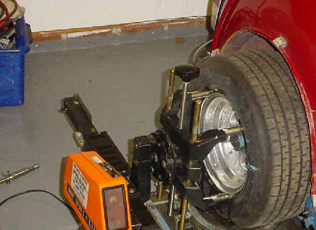

There is a problem here. I have never found a garage that has geometry equipment that will fit 10" wheels. The is, therefore, no way that they could have measured it.
With some string, 4 axle stands, a set square, a ruler, a sprit level and a spare afternoon, you can do it yourself.
You can see how I do it in the picture (old car, years ago, but I still use the same sticks and string.)

1/16" toe out I think?
The tracking gauges I have on loan off my Dad fit 10" wheels with no problem, they are the fairly common Dunlop optical type that you see fairly regularly, though I can't comment on tyre places not being able to track 10" wheels as I've always done it myself....
