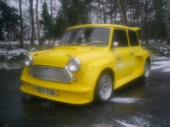

This is my mini bought a few weeks back..
It's a 998cc mini 25 1984
As you can see its had some work done to it but unfortunaly not to the best standards and is looking a little sorry for itself so at the moment it is in having some welding done and sorting some electrical issues.

Welcome to the site, spec sounds very good! Hope all goes well in the next few weeks, update this post with progress and lots of pics!!
