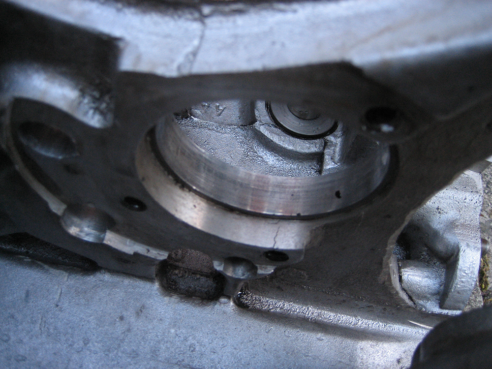

Doing my first gearbox rebuild and after inspection I found a crack starting to appear from one of the bolt holes in the centre web.
It's a late type box with only 3 holes.
Is it knackered?

I would put that in the bin...
Its only a bit of metal. If it blows it blows!

i would not use that
makes one hell off an ashtray(do i say that right???)
there is nothing wrong with a A-series that a turbo can't fix.
www.turbomini.nl
it will be ok for normal use
(ie) none turbo 70 hp.....ish
for a high blown turbo engine its ....GOOSED!
it will fail you in time

Thanks guys... looks like I'm on the search for a new gearbox.
Does anyone know someone who wants my big ash tray!
Nick.
Fit for scrap and nothing else, gearbox casings are easy enough to come by to make it not worth using a duff'un.

Make sure when you find another case that it has the 3 bolt bearing retainer like the one you have there, the 4 bolt cases snap easily with high power.
Throw it in the bin. Don't use it on an original 850 either.

dump it and find a 3 bold casing

What about this one?
Bat
4559 Posts
Member #: 786
Bermingum
That's FUBARd! *surprised*
