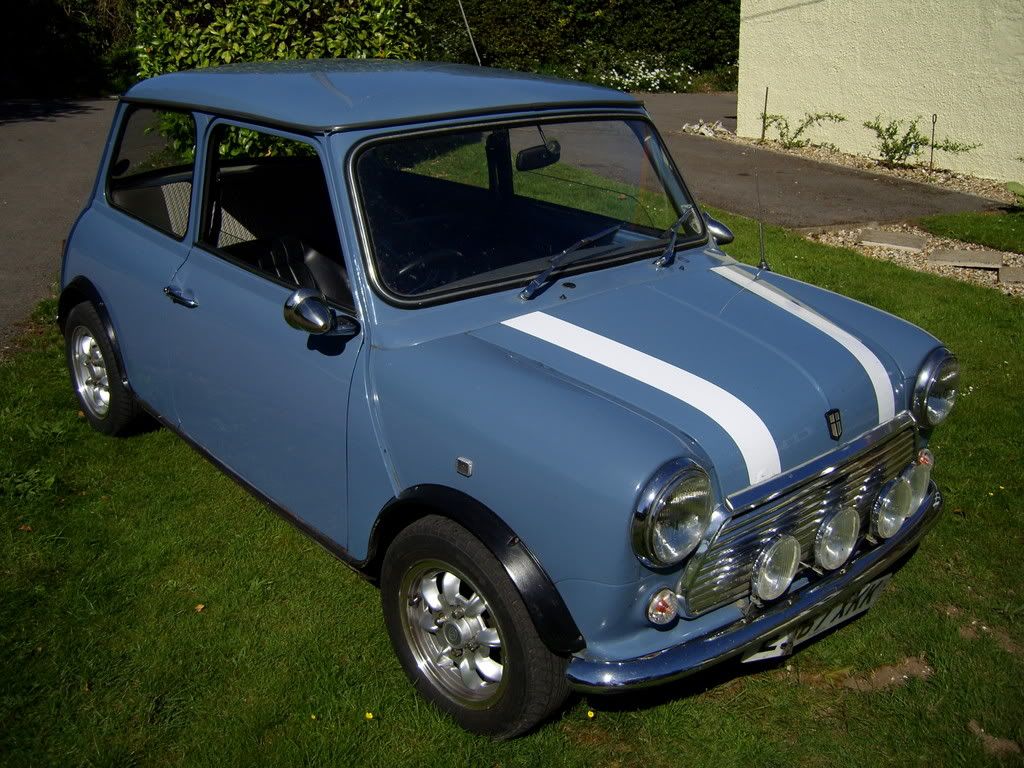

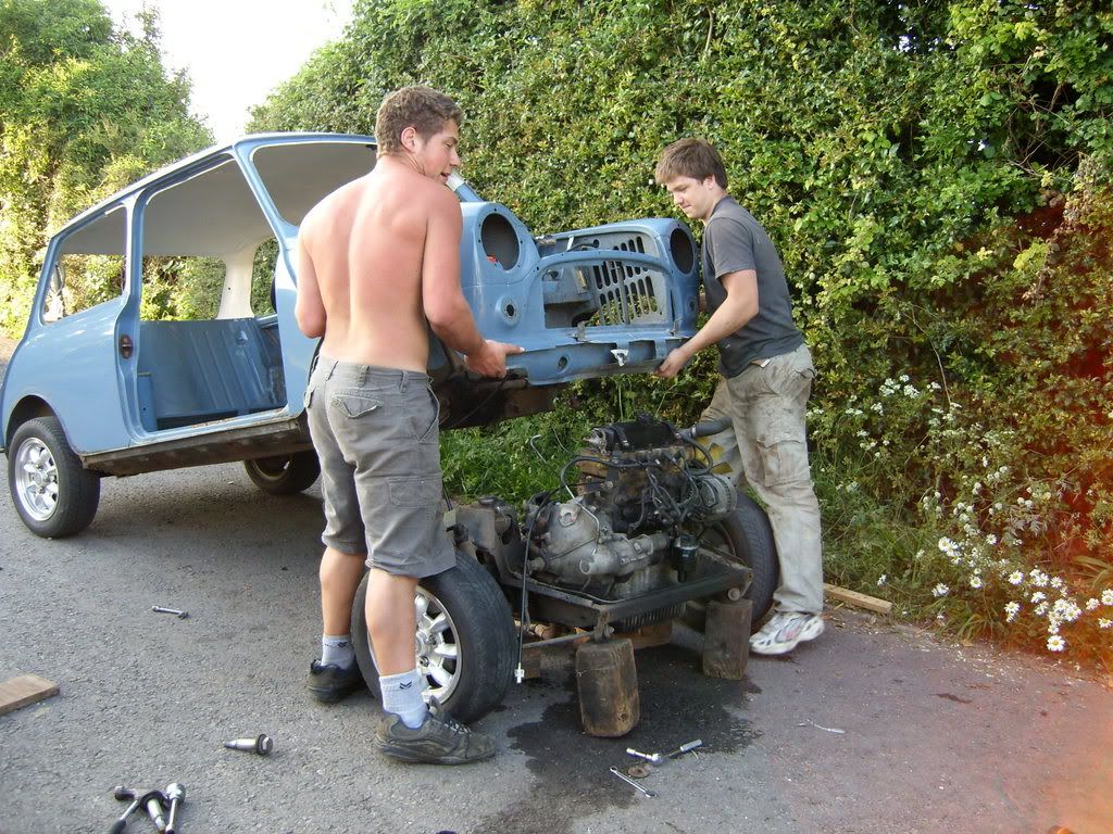

I have been waiting for nearly a year for the right time, but my car is finally about to come off the road for a restoration.
Tomorrow myself and a friend are going to strip it to a bare shell and begin welding. It is generally tidy, however rust is beginning to take hold. Rather then mess about repairing it now and again I want to get it structurely and cosmetically in a good state. subframes are to be fully reconditioned.
My plans are:
Restore the bodywork
A nice coat of blue paint with a pair of banging white striped up the middle! or more likely just green without stripes.
Lowered, 1.5 degrees negative camber all round
Riding on 13's - not decided width or offset. And yes I know there not 10's but I know will regret it if I don't.
1275cc metro engine with stage 1 kit.
Cobra monaco bucket seats.
well here it is now, and hopefully it will be ready so i can drive it to work by mid july. It is so annoying some of the rust has been allowed to take hold by the previous owner, because it could have been so easy to fix earlier.

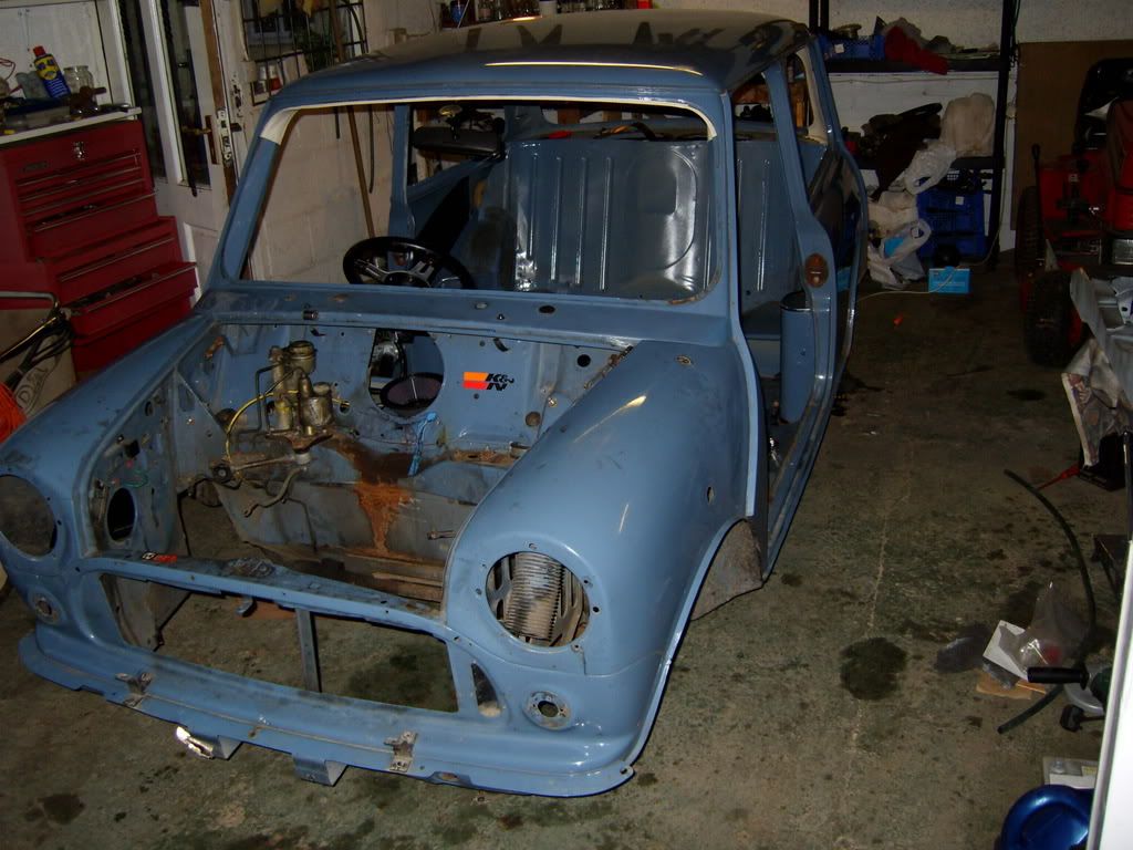

Well after a busy day the car is now a bodyshell and the garage a disaster. It all came apart smoothley yesterday apart from shearing a rear subframe bolt in the end of the sill - needs replacing anyway.
The only real nasty was the boot floor under the fuel tank which will need repairs and the drivers sill door step area. otherwise its small local repairs and the standard wings, a panels, front panel, sills. Thank god the heal board is sound as I was concerned it wouldn't be.

That don't look too bad.
I'd remove the floor from under he mounting in the pic and put a piece of sheet in right out to the bumper mounting flange (there's that word again *wink* )

Good luck. Looking at what you have to do, the repairs to the body shouldn't take too long. Just make sure you stone chip the underside when you finish so you don't have to do it again for a while!

mini machine in darlington make a nice repair section for that boot area pretty cheap! give them a ring they do delivery!
9326 Posts
dont worry about that area- just pop some tape over it, and then put the tank back in
(err thats what i did on my car....)

minimole your the bomb when it come's to getting down to stripping the car! looks ok to me few bits but nothing to worrie about!

I'd love it if it goes back together as fast though! Had a boring day of removing the last few bits and making a wheel about. then got extremely bored cleaning it, and pulling stone chip off the underside.
with regards to the hole I will get a repair section that runs the whole width as its all a bit crusty behind so may as well do it proporly. and water has got into the sanwhich of panels for the bumper so the valance will come off anyway.

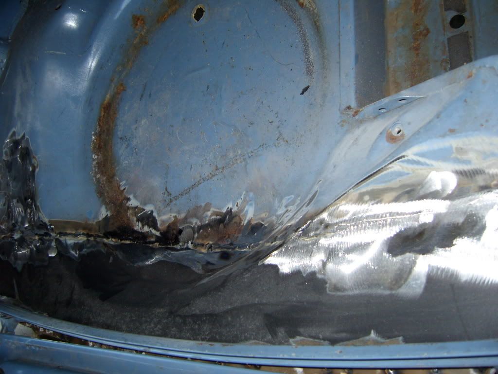

Had a bit of slow progress but I am now awating another unforseen order of panels.

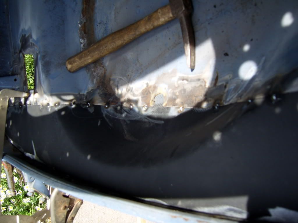

I am so pissed off I haven't got the oversills off fast enough to save the repairs that are now required. I now need to repair the whole doorstep area and inner sill and a bit of the floor pan.
Death to the garage the bodged them on to what was a not too bad sill. - the other side looks worse from the inside condidering there is already a hole and there wasn't in the side I just removed.
Oh well, now the boot floor is repaired along with the rear quarter panel. and I am going to start patching a hole that appeared when armed with a screw driver near the rear jacking point.

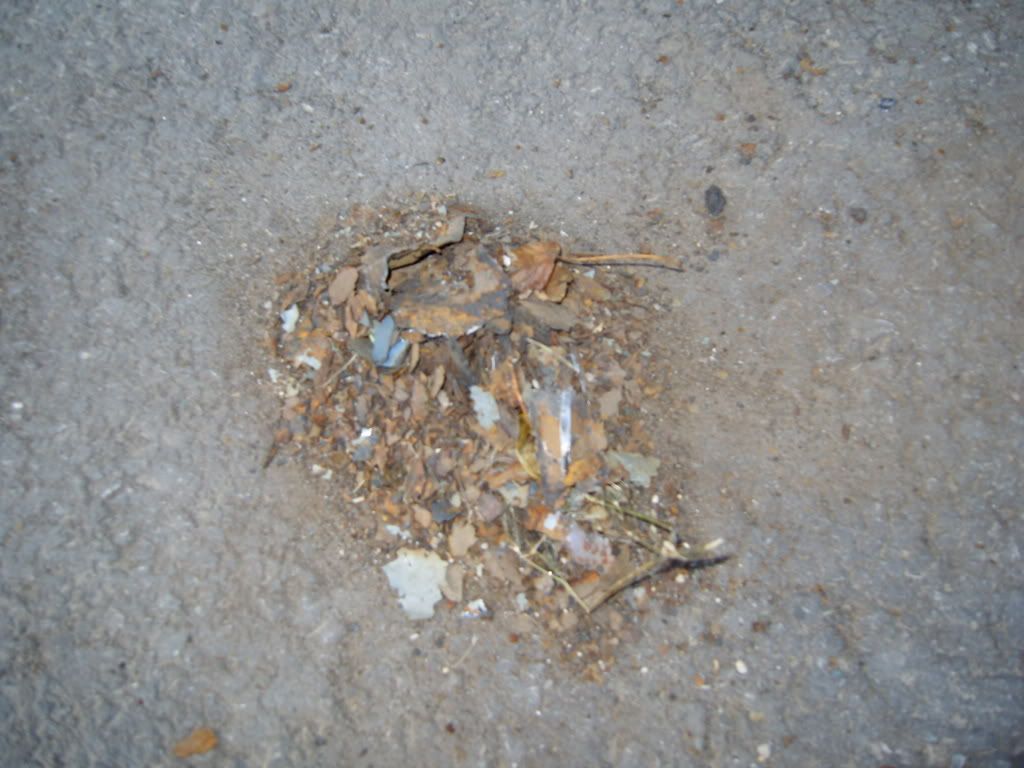

look what fell out the sill.
or brushed up

You have seam welded that rear repair panel in, haven't you??

4309 Posts
Yes.
