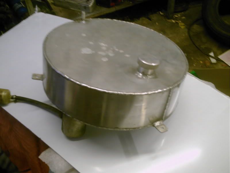

Some tanks use an internal collector with trapdoors....
Mine has this...although not by choice.
I wanted a "sumped" style tank, which had a small reservoir at the bottom, below the main tank, which should always remain full of fuel. Obviously this would have some form of baffling at the top.
9.85 @ 145mph
202mph standing mile
my one has a sump at the bottom that pokes out of the boot floor, the rest of it is filled with foam that will aparently do the trick

Build ths sump as big as it needs to be.,....
You really only need a reservoir of fuel down tere for say 30 seconds of hard fuel slosh...., so 1 litre in most cases should be more than adequate. In fact, given most Minis are carb'ed, smaller would do, as the carb itself has its own small reservoir-the float bowl.

Don't know if you've seen this one Fast Carl is selling?
Might give you some ideas?
