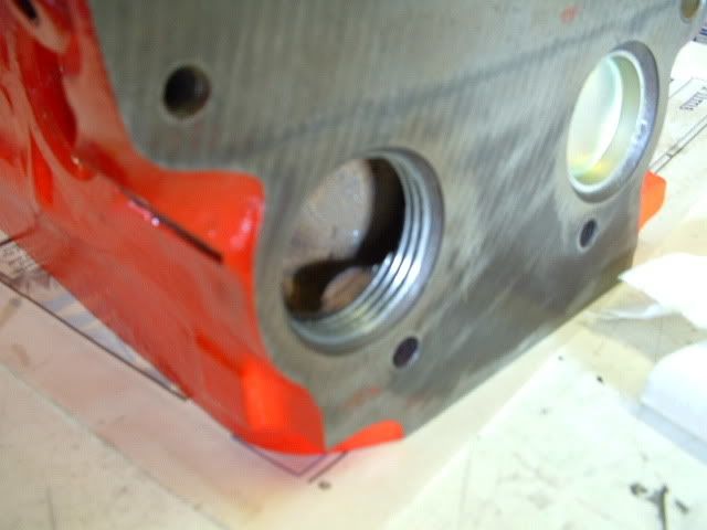

sorry if this sounds really vague, i will try my best to explain. Looking at the side of the engine and head above the clutch housing their are two copper inserts, one of this is linked into the water ways. if you take that insert out and make a collar so you can put a pipe on it. Then make a whole in the cylinder head in line with that. attach the U bend pipe then you are able to keep that piston cooler. Not very technical but i hope it make sense. I have the picture in my head what is should look like *happy*

I've done this on mine. One of the core plug recesses is tapped and a threaded fitting is added to connect the hose to. Then the head is drilled into the water jacket, near where the heater take off is, and the other end of the hose connected here.

i have had it done before, looks a great mod if it is done properly, whether it works, theory suggests it does, so all is good
