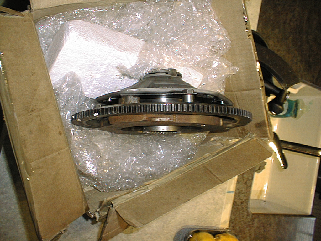

heres how mine looked:
clubminiflip
1840 Posts
Member #: 54
nr coventry
false alarm! take the piss i dont car! hehe lol *happy*
i've just hit my hand with a hammer for being so f$(%*n" stupid!!!!!!!!! about this clutch thing!
i'd put the diaphram on wrong, alls well at captain duuurrrrrrrrrgggggggghhhhhs!

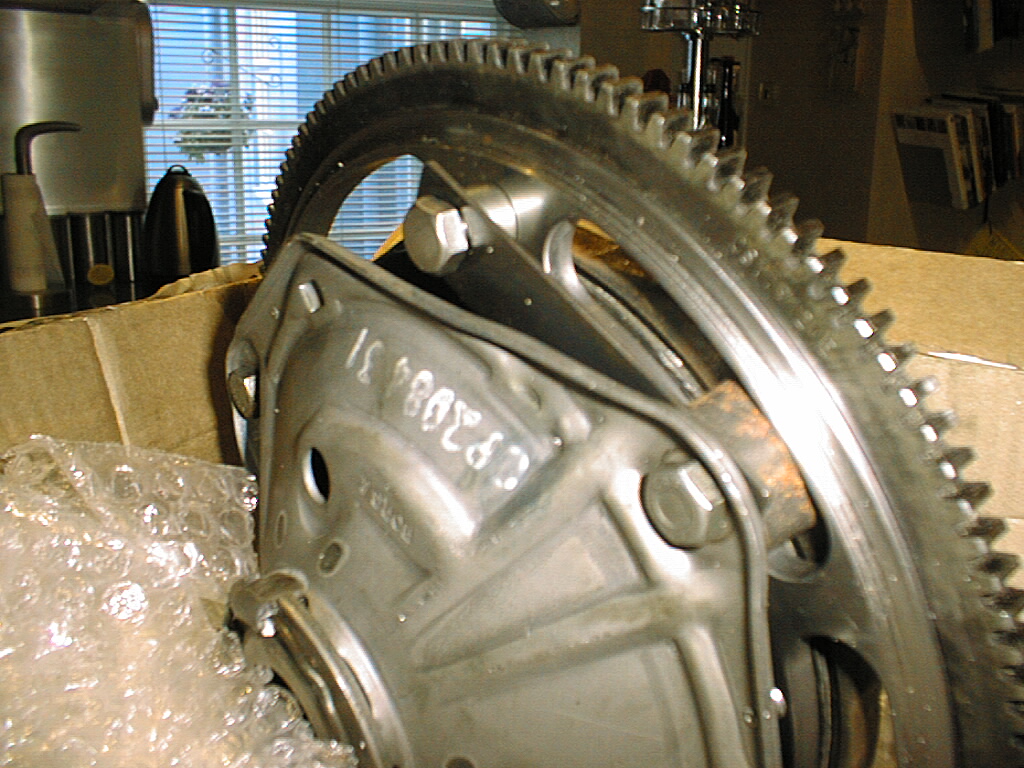

i've just had a quick go at opening my eyes & actually thinking about what i'm doing, a quick rotatation of the diaphram & alls aligned sweet as a nut! hehe i'm just loading a pic to make sure i've done this job ok!
"me dumb" urrrrrhhhh yeah i know!
clubminiflip
1840 Posts
Member #: 54
nr coventry
cheers joeybaby! mine looks like yours now! *happy*
i'm trying to figure out what it means to get the spring plate flat
i done a search earlier & was reading andyh's article
mine looks flat when the bolts are torqued down?
Edited by clubminiflip on 17th Jun, 2007.
good stuff, thats how it should be
