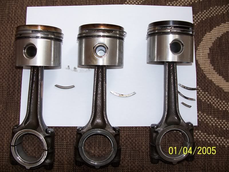

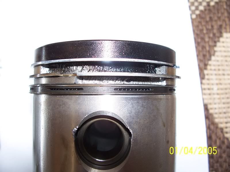

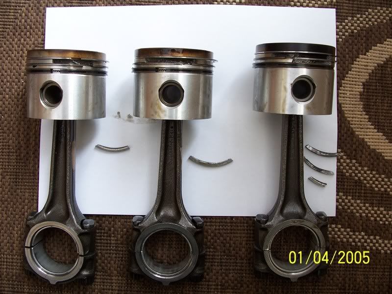

Hi had this problem on my way back from york at easter only number 4 down upon removal of pistons found that No4 ,3,2 had all broke there ring lands not a mark on the bores and all rings intact hope its not but sounds the same as mine .

No they were +40 AE hepolite turbo pistons, think it was to much advance and slightly lean mixture at part throttle 70 miles at 70MPH allthe way home was fine on the strip the steady drive home killed it!

yes that is the number on them they look like a decent quality piston to but nothing stops the dredded detonation
