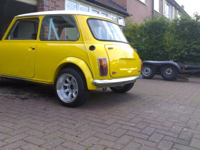

On 17th Aug, 2009 Jay#2 said:
i prefer the handling 100% now over the 13's
This is mine before I saw the light and went back to 10's
I'm a 13" guy as many will know (arf arf). However, Jims is the first car that I have seen that looks better on 10s. I preffered neils with the 13s.
Anyway. Carl, if you get it finished before Avon, get yourself to my house and I'll set the suspension up. If not before Avon, I'll do it after.
