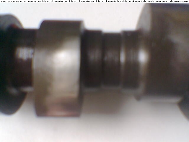

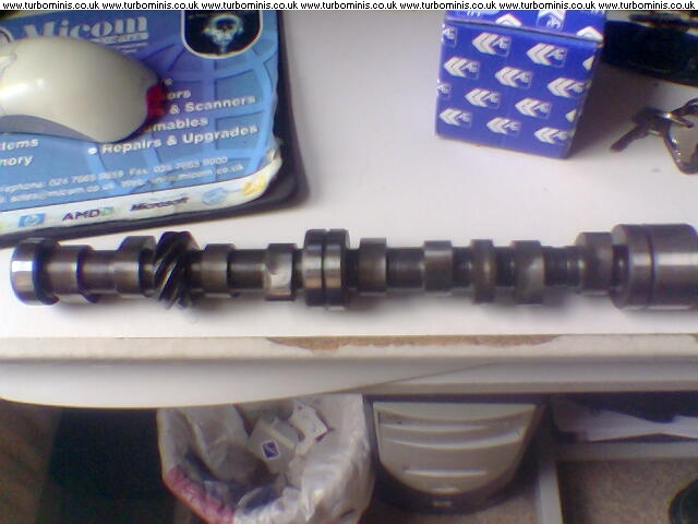

the cam is supposed to be an mg metro cam & going by ac-dodds findings mine has the 1/4" ring machined into it after the 1st cam lobe!

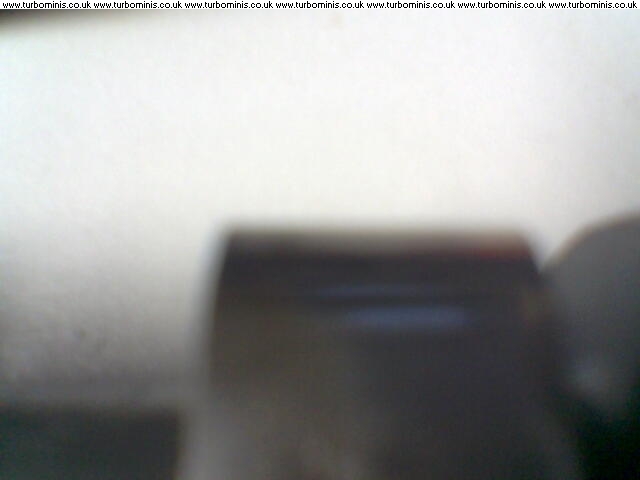

the bearing surfaces look in top condition to me, no deep scoring & the sear seems nice & even, lobes to me look ok, no pitting or chunks missing, but opinions needed as i'm a lil worried using a used cam! my followers & pushrods are new!

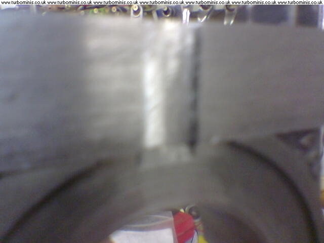

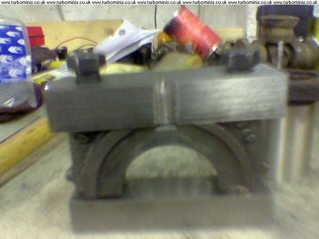

2nd is my moddded main strap with thrust grooves, i have to file it a minute amount for the thrusts to be a perfect snugg fit! not tight/not loose, just less than in interferance fit i'd say

Plenty of cam lube or graphogen on the lobes and journals when building it, get it fired up and straight up to 2000rpm (NO lower) for 20-30min to knock the followers in and it will be fine.
I can't see shit. Get some decent pictures.

Vegard. straight to the point as normal!
the pictures are rather crap, try holding the camera still

or try using a macro function if the camera has it.
I agree with Andre, macro function is what you need here.

vegard: lol *happy* i do apolaguise i think i have oil on my camera lens + the pics are taken on my mobile, i'll give it a clean *tongue* i was looking at your website last night, some really good stuff, sorta copied your groovyness on your ,mains strap *happy*
tom f: i have kent cam lube a full pot ready!
i cant get jack all here in cov like graphogen, hermatite, engine build lube nothing, the places round here are absolutely "cack" is the word! used to be really easy to get this stuff but i struggle now
will the cam go again do you chaps think!

2000rpm or more for 30min is ESSENTIAL when using new followers, fail to do this and you could very possibly scrap your cam and followers.
If the cooling system is working effectively this will be no problem to do, I've done it to many engines (mini and other) over the years no problem.

oh arr 4g0t to ask, do you chaps agree tha this is an metro mg,vandan plas mini cooper rsp cam???? i went on the ac-dod guide!
also whats the timing figure on it? what do i set it up too, cheers all, may put the shortblock together this weekend if all is well
