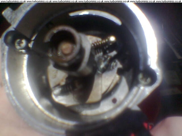

yes you need to stop the advance working if you want to time it at 24 .
Weld the bob weights to the backplate, job done...........if you post it me with a SAE I'll do it for you FOC.

opinions plz chappys, i've put a blob of weld on my dizzy in what i think was the correct place pic below, when looking at the spring in the dizzy sort-of in the top right the weld is below it! its stopped any movement of the bits in the bottom of the dizzy (sorry i dont know what they are called!
hope i have this right :/

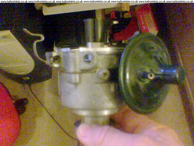

a pic of it now with its green vac advance! looks good in my view
