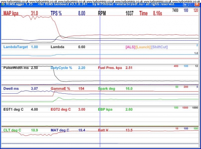

Data logging with VEMS is easy, and I would only expect it to be as easy with Megasquirt,
This is the VEMS ViewLogger

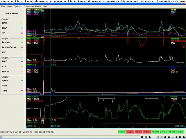

And this is the MegaLogViewer from the Megasquirt Forums. It is the very same data file used in the VEMS ViewLogger. Other parrameters are selectable as well.

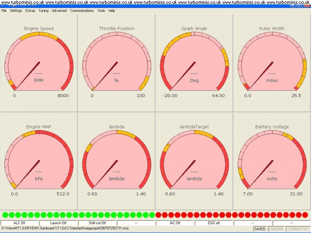

Both VEMS and Megasquirt use Megatune, but obviously the ini files are very different
I thought everyone knew data logging with Megasquirt was part of the package
