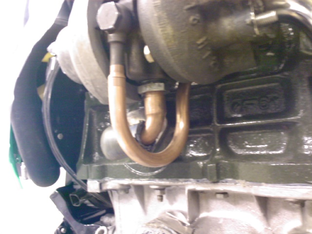

i think i have my water cooled fittings sorted ok but i'm confused where a take the in & out water feeds for the turbo???
oil is fed from the front of the block & drains into what was the fuel pump mounting
the water feed is buggung me though as i have a water heated inlet fanimold

i'm a lil worried about the heat frm the turbo melting water pipes or are they stronger than i think, is there any way i could chang the banjo fitting or weld some 1/2" mild steel or stainless tubes on to the fittings i have, i could use a plumbers pipe bender, just curious to how others have overcome this prob if it is one

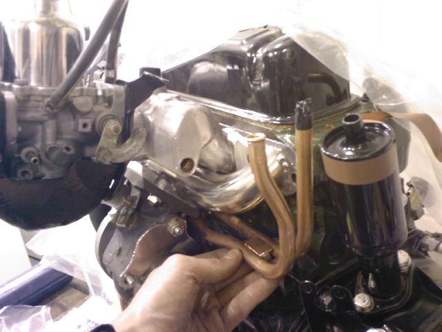

i've got banjo's kean & they have a straight pipe attached to them, i'll try to get pics cause i'm not to gr8 at expalining them in txt, it would be a bonus to be able to just jubilee clip some silicone hose on them, save alot of greaf!
i dont live far from the samco factory that makes the straight lengths of silicone hose, not sure of how flexible it is but the do all sizes in str8 lengths, for some reason they make the bends in wales???? WTF!
i'm a bit unsure where to take my feed & return for the turbo, do i juse use t-pieces

Hi I used the std R5 banjos and formed my own out of refrigeration grade copper, silver soldered them on, fits a treat, also made plumbing the heater in after the blower easier!
Hope this helps,
