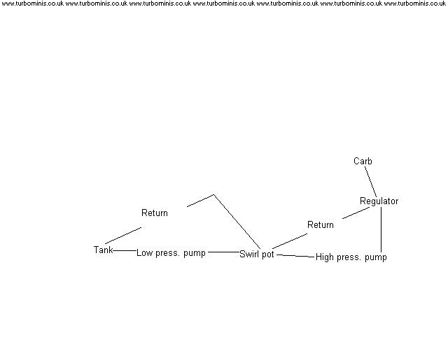

![]() 6549 Posts Member #: 1149 #1 Basshunter Fan Force Racing ICT Dept Manager Miglia Turbo Am frum Yokshyer tha noes! |
31st Jul, 2007 at 10:13:07am
Right.. Bat, this is confusing???
![]() 1849 Posts Member #: 672 The oversills police Oslo, Norway |
31st Jul, 2007 at 10:31:41am
excuse the bad drawing, but this is how it is supposed to be if I am not mistaken :
31st Jul, 2007 at 10:34:24am
ahhh. Obviously yeah because i know what im talking about!
