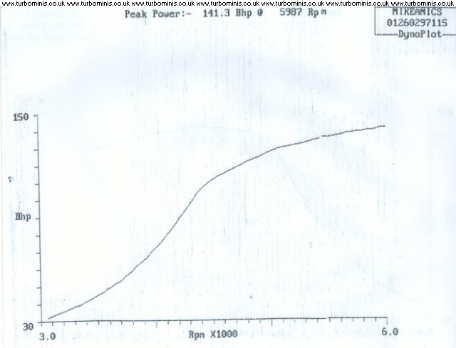

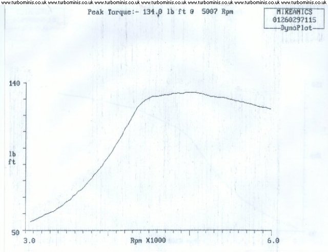

With 8.5 CR you could run over 20psi I should think, I've run 18 with similar CR and a Metro T3 (I assume you have the Metro T3).
You're not far off with where the power will come in, see my graphs below.
http://www.turbominis.co.uk/_photos/random-photos/74/550.jpg
http://www.turbominis.co.uk/_photos/random-photos/74/551.jpg
