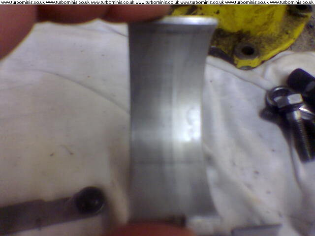

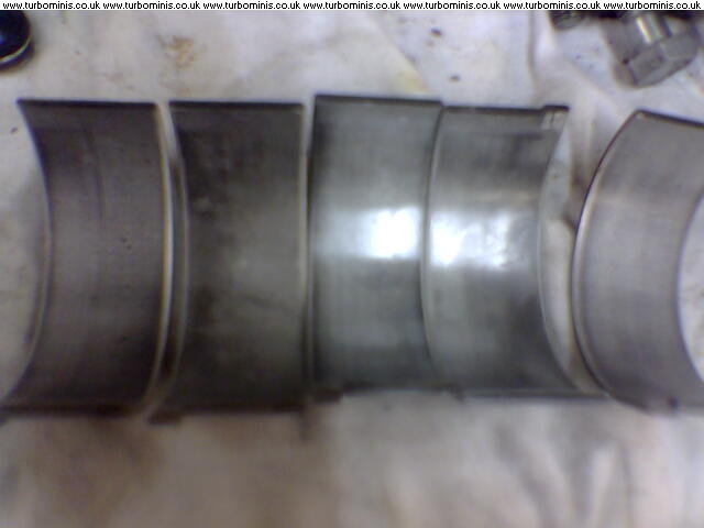

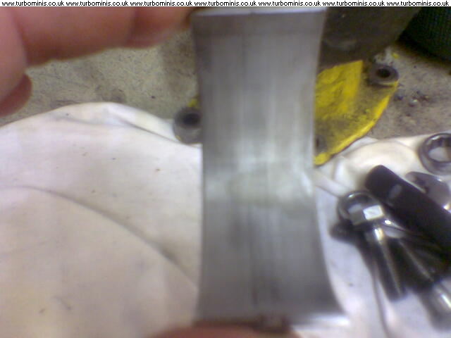

yep they've had some wear n tear but dont look that bad to me but i'm a novice engine builder at the end of the day!
opions needed chaps
much love terry tibbs
Bat
4559 Posts
Member #: 786
Bermingum
New ones everytime, surely?
Gavin :)
My Mini build diary
Look OK for used shells, obviously fit new when rebuilding.
Renew if rebuilding like tom says. There not really expensive.

i was only a lil worried about bearing the 1st pic, seems to have worn more in one area?
