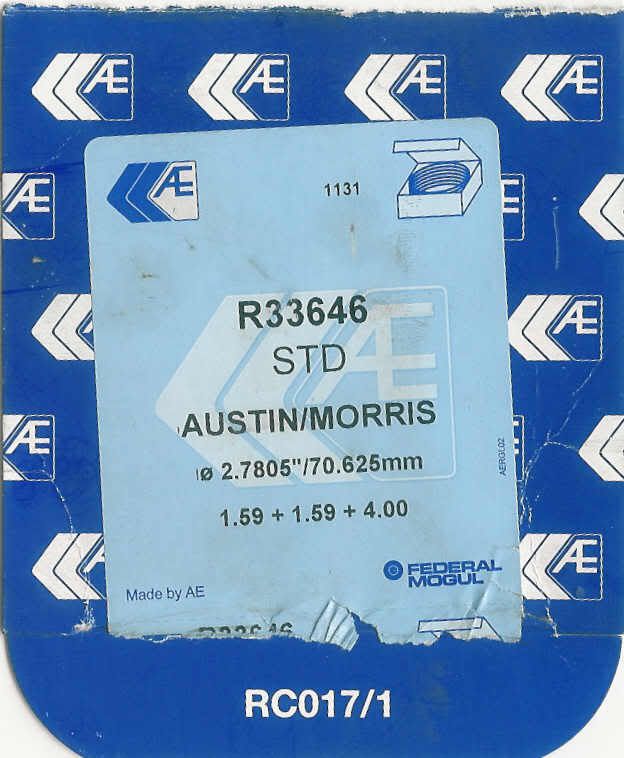

rings are availables new ,
just had a set last week,
I'll look if I kept the box , for ref
fab
1497 Posts
Member #: 100
Parisien Turbo Expert
Paris\' suburb
Edited by fab on 12th Aug, 2007.
