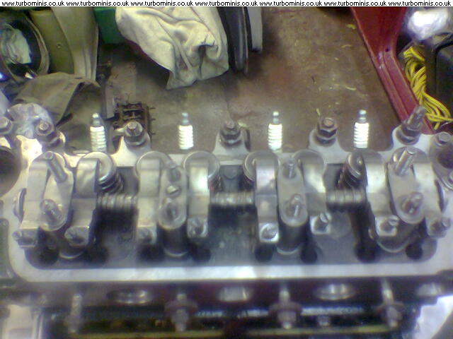

10th Aug, 2007 at 08:02:42pm
i have a prob, i've come to fit my rocker gear & its not sitting on the block, pic below will explain better!

10th Aug, 2007 at 08:18:49pm
no, the head is'nt torqued up, i was going to do the rockers 1st, the rocker post nuts are'nt torqued up either!!!! its all sitting loose

10th Aug, 2007 at 08:22:18pm
Its the valve/spring assembley holding it up ... loosen off all the rocker adjusting screws, then torque the head down making sure the pushrods are lined up on the rockers.

10th Aug, 2007 at 08:28:49pm
all my adjusters are wound right up into the rockers, it seems to me the valve & spring assembly is holding it up SKYLINES ARE LIKE CLITS, EVERY FLANGE SEEMS TO HAVE ONE: see this sticker on my silvia

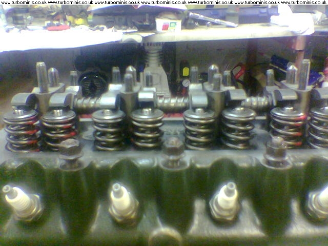

10th Aug, 2007 at 11:27:28pm
i dont know if these pics will help at all! they say a pic can tell 1000 words

11th Aug, 2007 at 05:59:29am
Stop fannying about and torque the head studs, this will pull the rockers down and open a valve or two slightly. Then go round and do your valve clearances, if you cannot get 12 thou valve clearance on each valve when doing it the normal way then you have a problem. However I am confident there will be nothing wrong.

11th Aug, 2007 at 08:05:58am
I would take the rocker shaft out , as it take nearly 5 minutes at this stage to see if it isn't bendt , in case it wasn't hold down by pillar nuts when you removed your head.

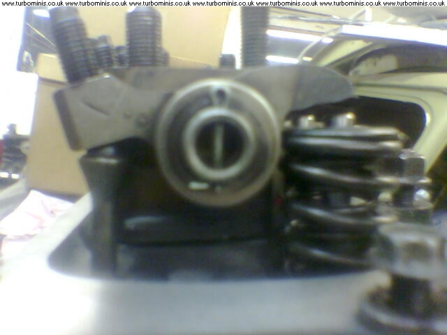

11th Aug, 2007 at 09:08:02am
tom i'm stressin cause it seems really tight on the rockers counting from the left number 3 & 5 in the 3rd pic above, & when tightened down they are solid, no room to adjust as i have my adjusters all the way in, i thought the rockers would sit down on their pedistals to the head nice & loose then torque it all up & do the clearanc's, the rest stay loose or loose-ish!
11th Aug, 2007 at 10:11:54am
Looks to me like the rockers are fouling the spring caps before touching the valve stem.

11th Aug, 2007 at 06:42:08pm
If the rockers are not fouling the springs or top caps, then it is all in your imagination.

On 11th of Aug, 2007 at 06:49pm clubminiflip said:
is it normal to feel tension when tightening the headstuds up that go through the rocker posts/pedistals Yep, the valve springs are resisting compression as you open the valves. Saul Bellow - "A great deal of intelligence can be invested in ignorance when the need for illusion is deep."

11th Aug, 2007 at 08:00:08pm
Like I said at the start, and Tom and Steve have also said..... torque the head down, the valves will begin to open and the rockers will clamp down.

11th Aug, 2007 at 08:31:22pm
its more than likely that the cam is in the up postion so thats why it wont sit down on the head.
