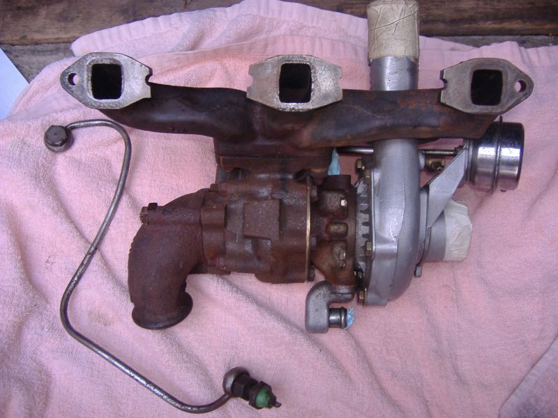

Am I correct in thinking the part on the left is an oil feed for the turbo?
It was in the oil feed hole on the turbo manifold, seems a little tight reaching the large oil feed on front left of the block though. It looks as though it might route underneath the top engine steady.
Hate to ask obvious questions. I've had a good search through the forum but couldn't find anything recent on where to source these bits
Is there a cheaper solution to the £55 Avonbar Aeroquip feed? Also need oil return and flange to go to the back on the block, can't see anything listed on avonbar though?
Yes it's the oil feed. It should reach the oil pressure takeoff with ease if routed correctly.

The little brass t-piece on the turbo near actuator. One feed to the actuator and one to say a boost gauge?
Sorry for the obvious questions just trying to get my head round the operation of the turbo. Ive got about ten threads open haynes manual on my lap and pencil and notepad in my other hand lol don't wanna fudge it up.
I plumbed mine in like that and found that the more air I bleed off the less boost it showed on the gauge (but I was actually running more boost) *surprised*
One side goes to actuator the other side either block it off or run it to a bleed valve. *wink*
Edited by matty on 14th Aug, 2007.
Bosst gauge shoud be fed from the manifold
Ric
1566 Posts
Member #: 36
Basingstoke
yeah, you'll only see boost no vac if it's before the throttle butterfly. Like matt says, use one outlet for actuator and the other for bleed valve.
