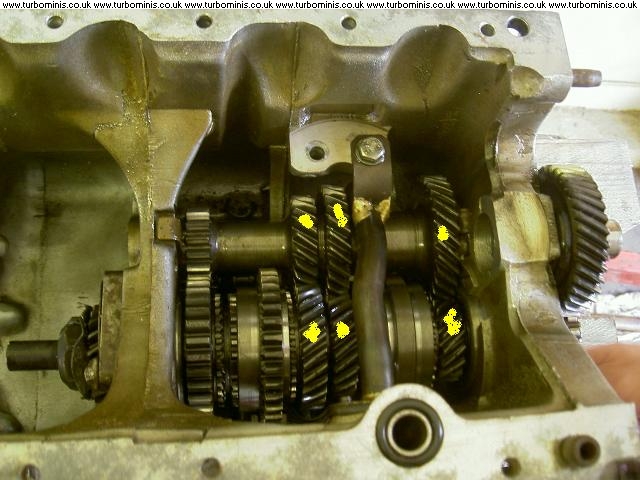

This is my gearbox http://www.turbominis.co.uk/_photos/random...os/694/3953.jpg
So the ones with the yellow dots, there the ones i change..

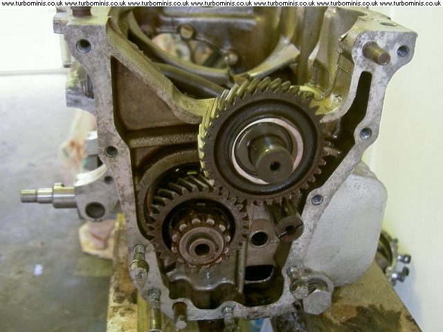

What about these.. do these have to be changed ?
http://www.turbominis.co.uk/_photos/random...os/694/3954.jpg

Those are 2 of the 3 drop gears. Try to get a S/C set if budget allows, or they'll probably pop sooner or later.
