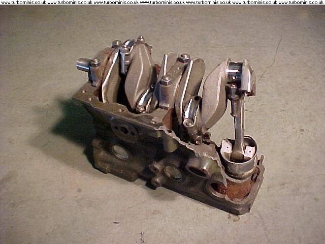

This is (was) a thin-flange S-Block race engine that did the unthinkable, and took out a lot of nice parts...

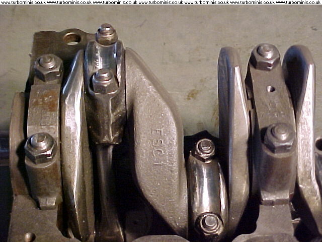

Just curious as to the big end nuts that are on there, main bearing nuts dont look too clever either.
Whats the chances that it let a main bearing go first??
I'll buy the main bearing caps if they are still ir workable condition

Pmsl... I might be mistaken, but those big end nuts look like nylocks!!!
Just curious, but all performance engine build specs tend to specify that the centre main cap should be braced.... The centre main here still seems to be well attached.
Edited by CR# on 31st Aug, 2007.
S bottom end,
I have seen the rod bolts with (high grade) nylocks before.

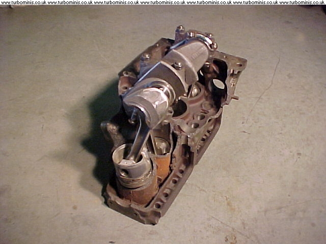

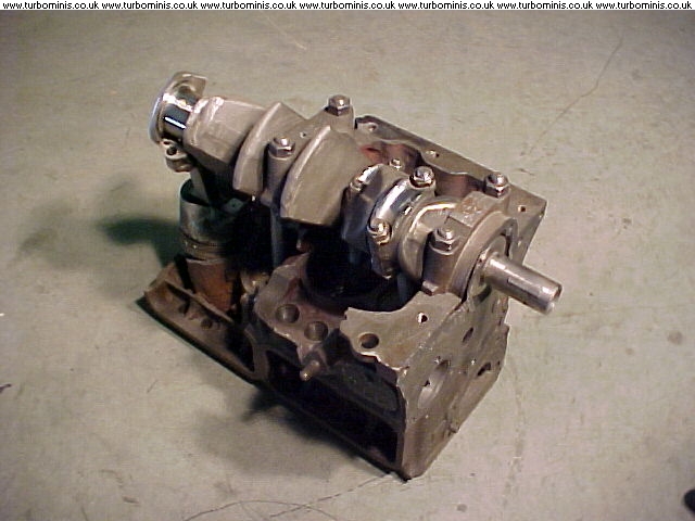

My new theory is that the engine has been run at high ish rpm without a crank damper for a prolonger period of time, the crank has fatigue cracked at main bearing number three, resulting in the broken halfs of the webs climb over each other bending the crank and ripping the block in two. Number one and two main bearings still intact yet half of the casting missing on one of the ceter bearing studs, so dont see the block as being the intial failure.
All I can say is, the bloke used a thin flange block, and probibly no crank damper.
Edited by Sprocket on 1st Sep, 2007.
I'd say that was a quite feasible explanation personally.
