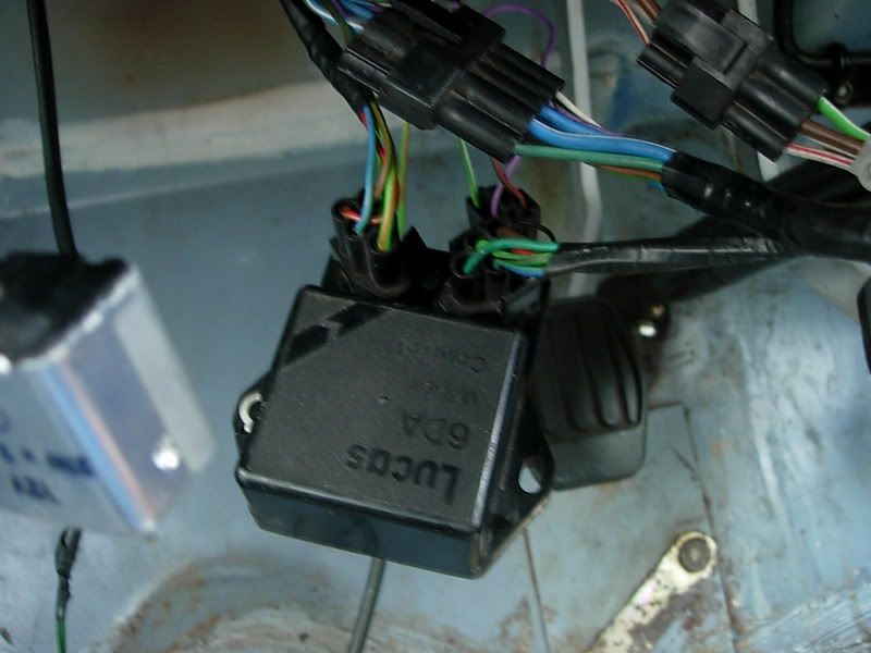

Cars in portsmouth at home at the mo. Ive tried everything to my wiring skills which isnt very good and I just cant seem to get it all working!

Hi, Have you got a big clump of bullet connectors by the bonnet catch? If so start there for lights, indicators we'll come back to later..... Get a test light, and check power to and from all fuses. Brown and purple wires for the horn. Light greens for the wipers. EDIT: I'll do it for you at a good price if you're transporting me
Cheers, Gavin :) Yeah have plugged the lights into the bullet connectors at the front of the car and all connections are secure. I'll check the power to and from the fuses tomorrow when theres some light. Should i be testing the fuses with the ignition on or what? Ive used a continuety tester on the terminal for the horn on the stalk, but get nothing with the ignition on and the horn engaged! |

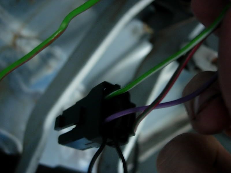

Hi, Never seen a 6DA on a mini, so bin it and put the 2 plugs together as they should be. The spare plug looks like it maybe for the hazzard flasher unit, what colours are the wires? As far as the horn goes, on the column multiplug there should be a purple and black wire, this should go live when you press the horn. If not check for a purple wire in the same plug, this should always be live. Cheers, Gavin :) Ok, ill try taking the 6DA out of the system and see what I get. I already have the hazard flasher unit plugged in, its up by the wiper motor itself. And the indicator unit is behind the dash! Ill have a play checking the horn connections tomorrow and get my findings back on here. Its hard to say what colour the wires are to the lone connector. Its either: LG/W - R/G - PU or W/LG - G/R - PU |

The spare connector looks to be related to the 6DA, it's got the same colour wires as the connector on the upper right of the 6DA in your first pic. Might be meant to connect to a dash mounted control so you can vary the intermittent time but not sure. You can always remove the 6DA as already stated and simply reconnect the two loom connectors back togther |
