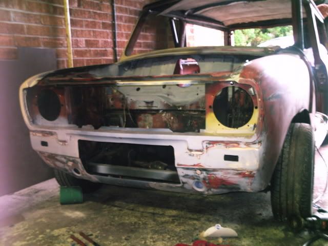

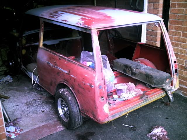

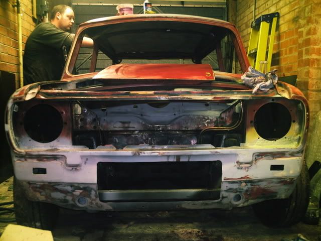

Finally decided to get rid of the Matt black and get some proper paint on the car..
The first one is as it was for those that don't know...
Mr bud666 rubbing vigorously as per usual ....*happy*
Hopefully will be ready for primer in the next few days....

urghhh that takes me back
keep up the good work, which colour?

all i've done is helped with the sanding, got mon/tues off work aswell next week so we can get it painted.

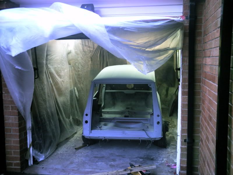

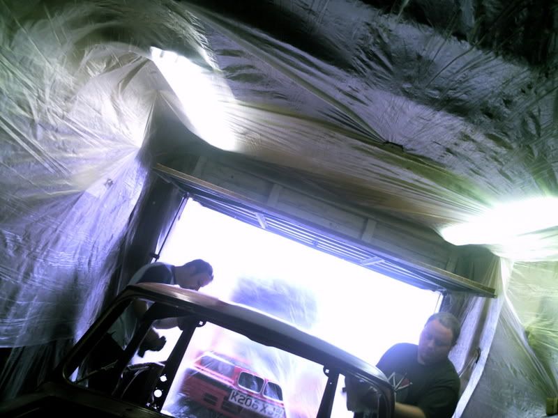

Some updated pics..........

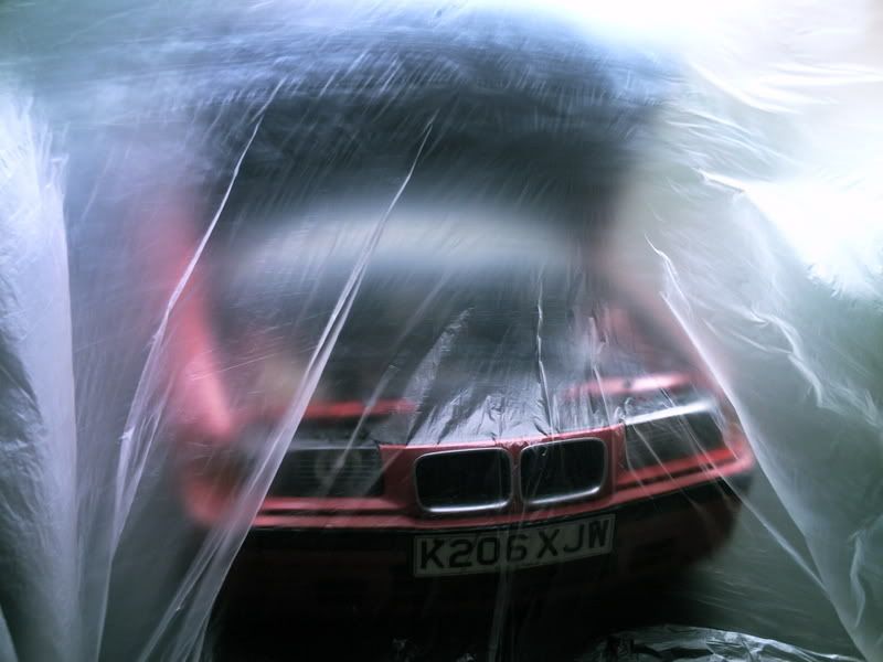

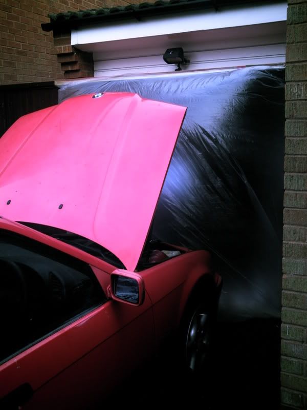

Please take note of BMW used as wind breaker for the cocoon spray booth!

I did try to convince my mate to spray the Bm but he declined lol.
Had a bad day today, the primer re-acted in a few areas with the paint underneath.
We spent all day sanding it back and trying to eliminate the problem.
Finally I think we have cracked it and should get some more primer on tommorow and then hopefully some colour.
big thanks to Nick (Bud666) for his help.

fingers crossed thats the last of the paint reactions, should definately have it fully primed and maybe a lick of beige tomorrow.

good work. isnt there some stuff that you can buy to spray on to seal the shell and stop the reactions. might be worth doing. ask at the paint shop
There is indeed, BARCOAT, however if you rub right back to bare metal in the affected areas and then panel wipe you should be OK, I'm sure you know this anyway.
