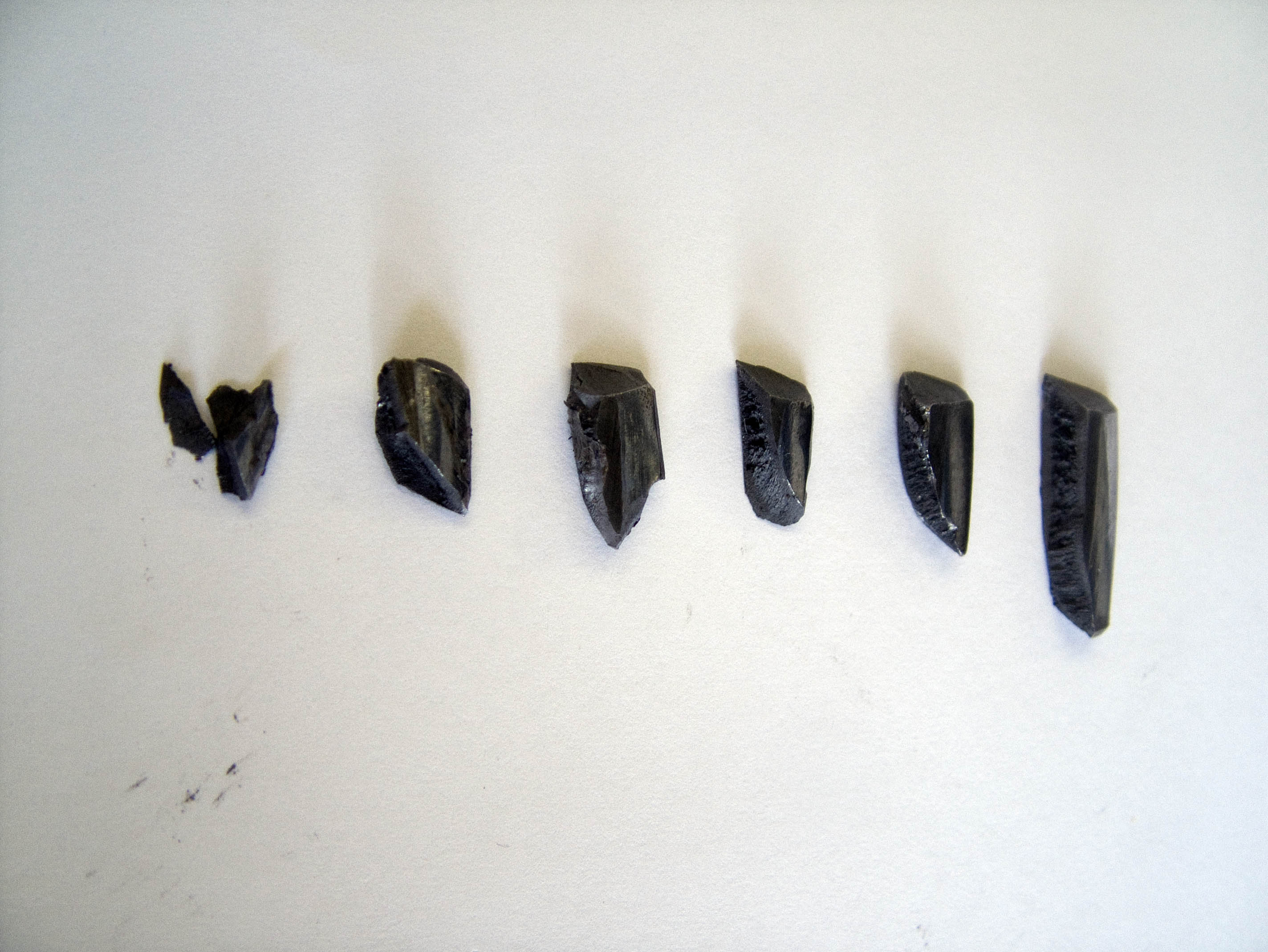

I was on my way to work this morning, when I nailed it in 2nd and had the most awful crash and grind from the box! I managed to get it into a driveway to a vets before I came to a halt.
It's been running around 14psi for the last couple of months with a standard box, drops and diff, so I was inevitable really.
All of the gears still select, but there is no drive to the wheels, just a horrible noise. Could it be the diff?

Here you go:
The pinion eh?

Or like that?:)

http://www.turbominis.co.uk/forums/index.php?p=vt&tid=10138
No good pics of the pinnion there though. It lost half of its teeth
Looks about right. I think that there's a few teeth left, as I can get a split second of drive until it grinds again.

my money is on the input gear has stripped its teeth, thats the normal place on helical boxes but dont count out all the above.
I think that I might use this chance to insert one of those indestructible 'Hoggy' boxes that I've been hearing about.
yep id go with the hogmiest
er on this , the gear from the input to the laygear ,broke on mine the other day , in just the same way .

Glad I put that straight cut 3.76:1 in my box now ive seen that. The pinion is small on the 3.76, it must be tiney on the 4.33, all that torque with an LSD, the pinion would want to walk over the crown wheel

Im with hogster too thats where ive done a couple of box's in the past. Plus the booting it in 2nd and crash/grinding sounds familiar *laughing*

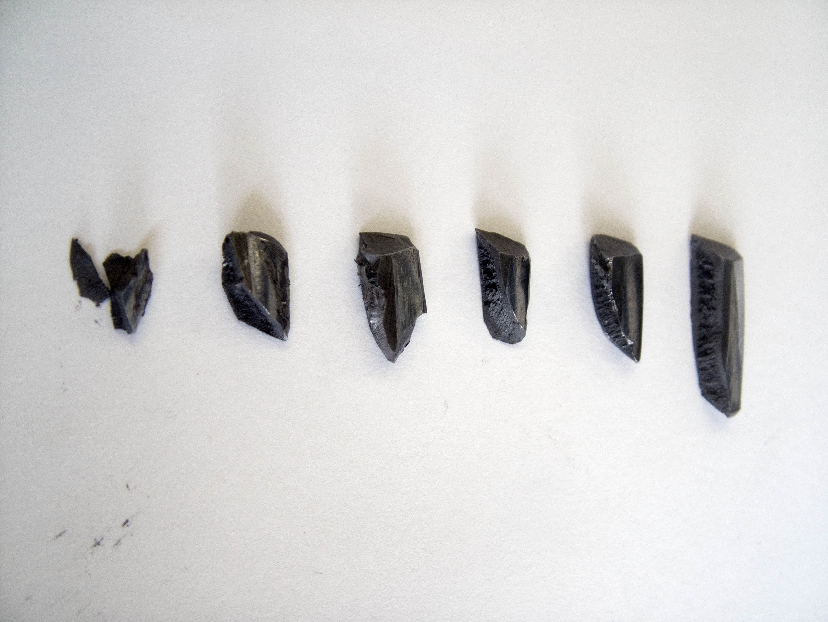

Here's the teeth that made it out of the sump.
Anyone fancy guessing what they belong to?
I reckon a broken gear of some kind.

think they look like pinion teeth

Yes, compare them to the broken teeth at the top of the page.

yep, I have seen them before you know:)
