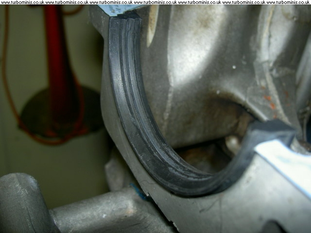

Is this Rubber seal on the gearbox the right way round ?
http://www.turbominis.co.uk/_photos/random...os/683/4052.jpg
And is it meant to sit abit proud on top and on the side ?
Plus do u stick it down with something, or place some gasket past round it..
Cheers...

IIRC you need to fit that to the engine...
Gavin :)
My Mini build diary
on the engine, and other way round i do believe
Indeed, you press it into the block not the box, and it wants to be the other way round!

Out right :)
So will it seal ok with out anything like gasket seal etc..
Cheers for that..

I have never had one seal without sealant, I think most on here would recommend wellseal? correct me if im wrong guys.

Nod from me.
yep,
you want the engine block upside down, then lift the gearbox on, its easier that way!
aparently wellseal is the nuts, but i have also had good results from loctite 574, the orange stuff.

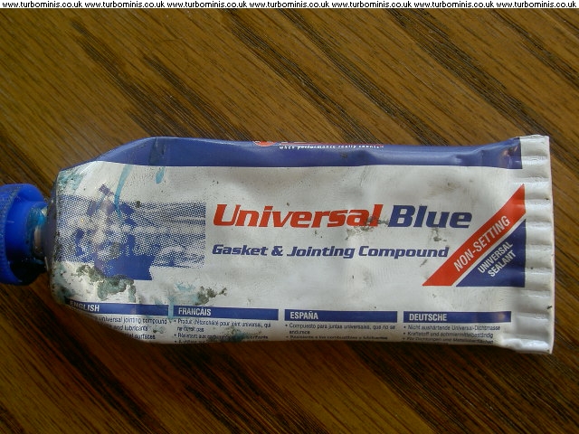

I have this stuff ?
Anygood.. http://www.turbominis.co.uk/_photos/random...os/683/4060.jpg

Read the posts above. Then use the information therein to make your own decision.
To me its quite clear that a few people have recommended Wellseal, and someone else has pointed out that clear silicone isn't always of good quality when subjected to oil.
From this make your own choice.

I know that tom.. but as ive got the stuff in the link, i thought i'd ask if that would be ok, as it's a little like the wellseal. and i wanted to get the engine on the box today..
Bonjour.. ill get some wellseal lol
Your one serious guy tom mate lol *wink*
Shit Happen's
Its nothing like Wellseal, that is a fact.
