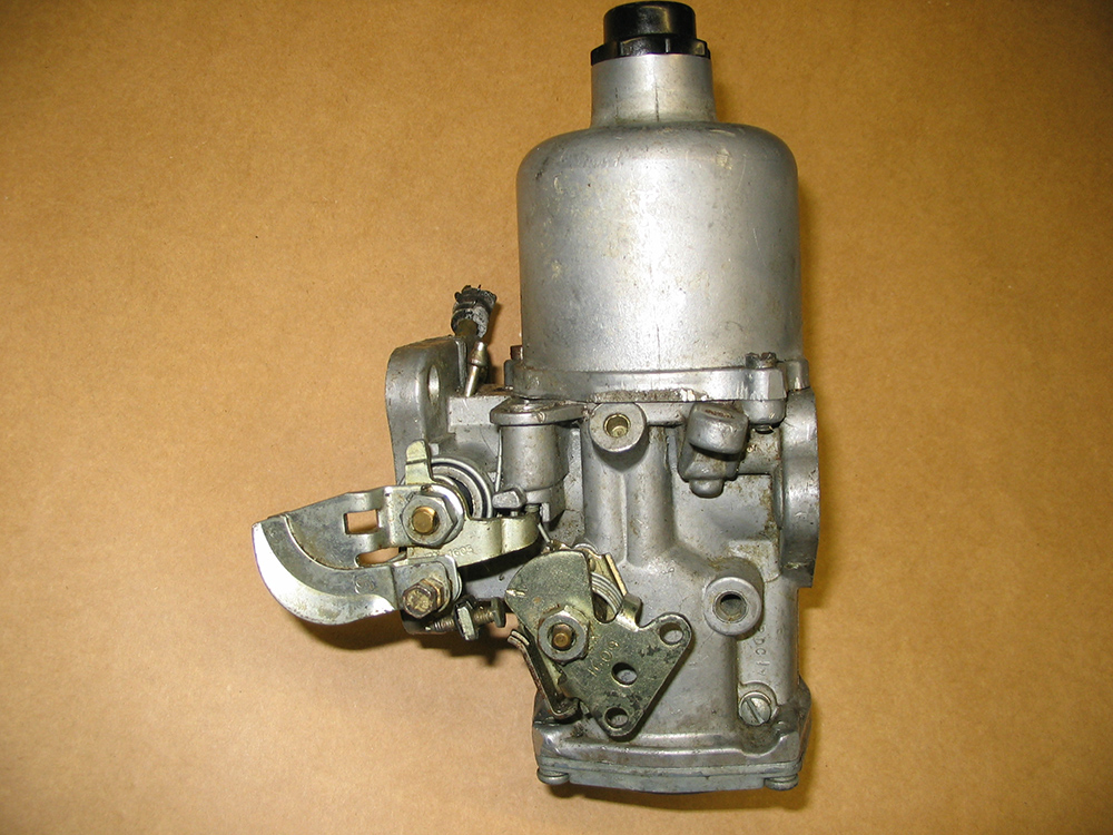

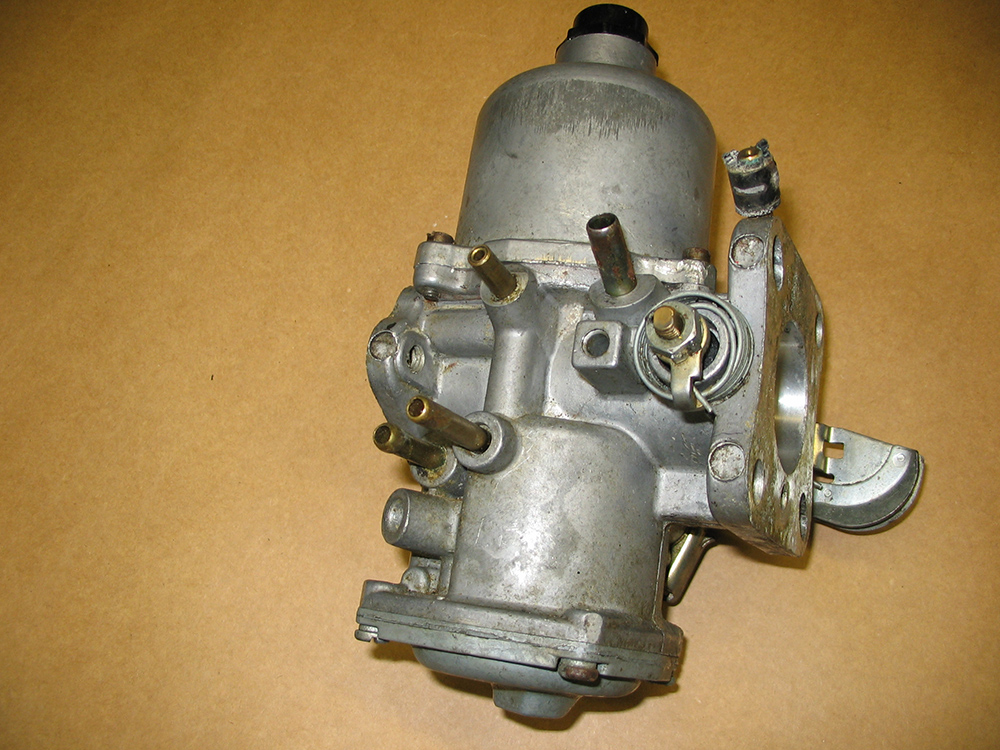

Thanks, Ive got a carb im going to list on Ebay and just making sure its a turbo one. Would you say this is a turbo carb ?
Thats most definately NOT a turbo carb.
Oh well thanks anyway, I was told it was because of the extra pipe on the side but thought i better check first *oh well*

Nope, not a turbo carb.
Turbo carbs usually have a clamp around the dashpot plastic screw top with a matching groove to secure it.
Dashpot screws are usually a domed nut type thing, not straight head screws as per normal carbs....Although any I had, I changed to Normal screws for ease of removal.
Interesting, the ones I have got/seen have all had normal screws securing the dashpot, it has always been the lower float chamber cover that has had the odd screws, perhaps this is what you are thinking of?
