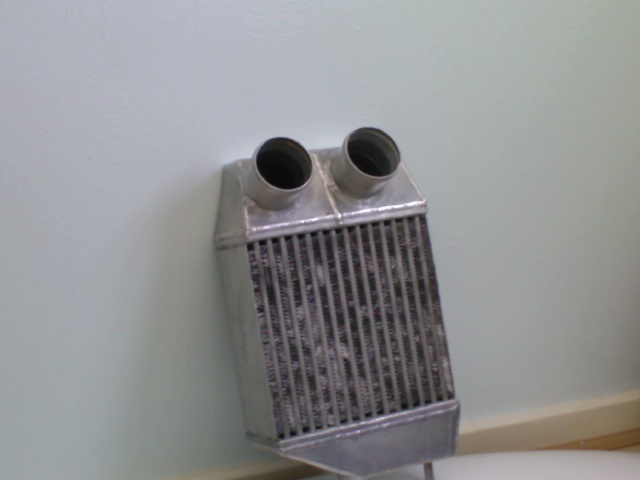

Having some problems getting my RST intercooler to fit without having to plumb IC pipes like spaghetti so i'm after the R5 IC as it has the inlet and outlet on top. Any reasons why this IC should not be used???

no, but it is a bit fat
Bat

Make sure you bypass the poxy internal thermostat. You should have a bucket load of room under there for a Cossie one though *wink*

The Renault 5 unit is a bit of an arkward one to fit. It's a thick unit, i had real trouble when i tried to fit one.

There are a couple of aftermarket ones with no silly stat and a thinner core, worth hunting one down.
I had an R5 one fittde. The only place I could squeeze it in was in the inner wing on the drivers side.. TBH I would go for an IC that fits up front.

They are only good for about 15psi of boost then they start blowing the caps off! you can get around this by fitting a big jubilee around it, but if you can get a alloy one then that would be better! There are better options though!

ah thats why I see them already 'strapped' :)
Depth is not really an issue where I want to install it (just infront of the wok behind the grille. I like the R5 IC as the pipes are both at the top and routing is easy, the RST on would mean a couple more bends and an awkward route. I'd consider the cossy one but i'm not sure if there will be room above the MPI rad, whats the dimentions of it, and which is best as i see referalls to 2wd and 4wd ones.
The 2wd cooler is not as deep as the 4wd so it will be alot easier to fit in.
There is some really nice ones on the bay that would do the job nicely in a clubby although a litte more expensive!

I tryed fitting a Pace R5 cooler in my minus when I did the dummy fit of my engine, Its a mahoooooosive chunk of metal to try and fit in, (that and the less bay space I have didnt help) if you want some dimensions let me know, Ill go measure it.

The pace collers are slighty bigger than the standards though!

Sure are, with noticable increase over the std ones too!
