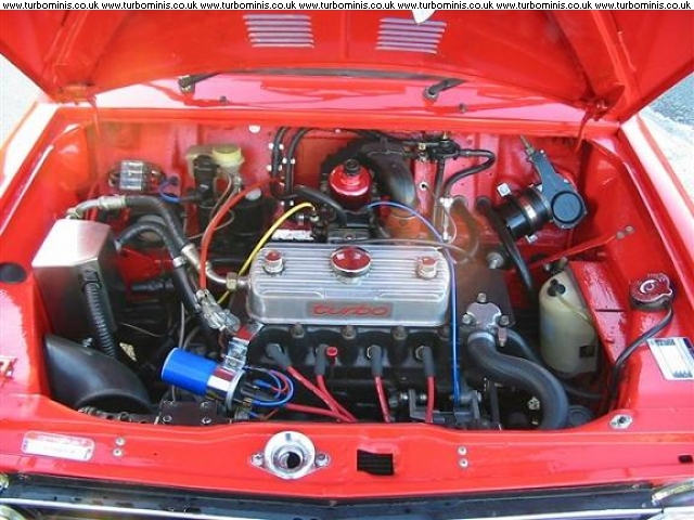

I have the mk1 rad at the front, an oil Catch can made up, and its real tight in There...
The pic was what My car used to look like.
http://www.turbominis.co.uk/_photos/random...os/683/4065.jpg
But now its just had a make over, Which has not been finished yet.
But it will be the same set up.

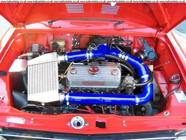

Anyway. ive done a search and come Across Tim's (known as Metro Turbo) Post. and he had that intercooler on his MG metro turbo car. So i thought, hmm That could work.
So this is what it would look like if i did It his way.
http://www.turbominis.co.uk/_photos/random...os/683/4066.jpg
Not sure where i would mount it.
Would that work efficient enough ?

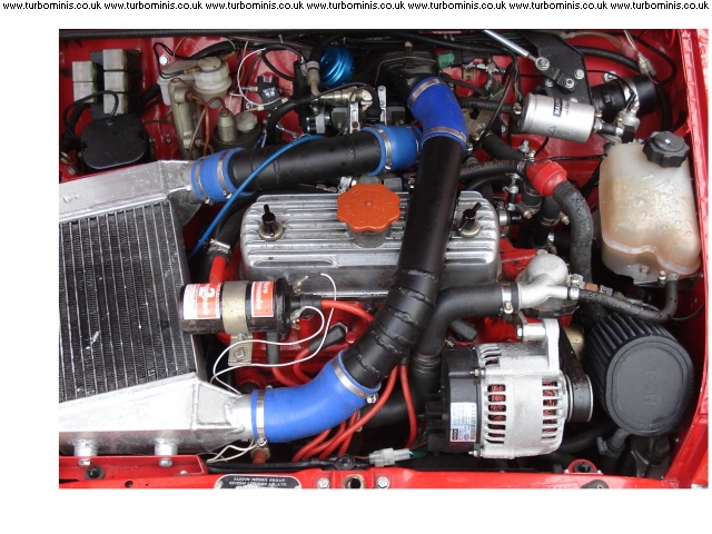

It will fit in honest. I managed to get one in my round nosed all steel sheel that has a Mk2 Metro rad in the front.
It's not realy about needing the intercooler, It's about the extra 20hp you will get because of it.
Do the job properly and fit the IC.
The IC is so important, I would suggest putting a standard mini radiator in to make room for it.
Looks good...
What sort of intercooler is that mate ?
Cheers..

I had it made as a one off by Pace as I couldn't find anything the right size at the time (early 1992). If I was doing it again now I'd get a Cossie intercooler and save myself a small fortune!

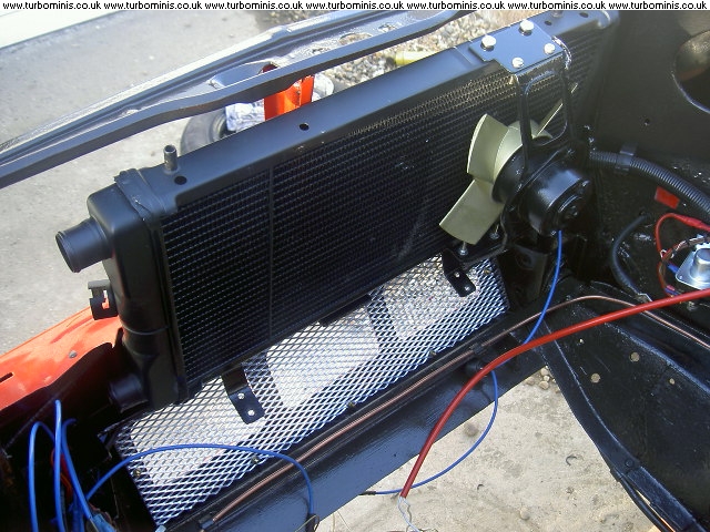

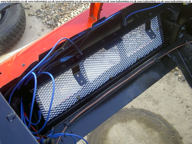

Well, This is the big mount for my rad to sit on. http://www.turbominis.co.uk/_photos/random...os/683/4069.jpg
And this is with the rad in.
http://www.turbominis.co.uk/_photos/random...os/683/4070.jpg
I dont want to lower the rad, as the setup is ok. it be to much Farting Around Lowering the rad, it just wont work out etc..
But at the bottom there is room for a Intercooler *tongue*
The room i have is (L-540 X W-130 X D-80 )
Is there one around with this kind of size ? but i dont want the Part Where u connect the pipes to be at the sides. more like the Back Of the intercooler, as that give me more room..:)
