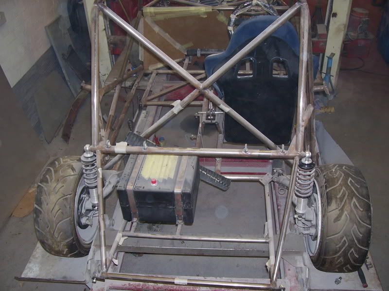

Wanting to fit an anti roll bar on the mini but unsure on wot when why where ?
Kad do one but it fits to the back of the subframe and as i havent got one i could make brackets to fit it. Just wanderd how much stress is involved as the tubes arnt very big at the back.
It would be better to fit it where the radius arm bolts but dont no wether they go above ,below or if the exhausts in the way ?
Am i best getting one made like the miglias as they seam to run all kind of different set ups.
Hope some of that makes sence. Any help much apreciated as usuall. Thanks Rick
Added a few pics

You've got one of them there tyres on the wrong way round...
Gavin :)
My Mini build diary
lol thanks.
I think it will be a case of addapting one that someone already makes or fabruacating one from scratch.
Jims runs inside the boot and could be mounted above your fuel tank possibly.
The other ption is to mount it to the rear on the two bars running down to the rear member. Again, you would need to make mounts and drop links, but a 'standard' one off the shelf could be used as a start.

Yes going to have to buy one and make it fit just wanderd how much stress was involved with one and if those rear bars would be strong enough as thair not part of the strength just ad on's to mount tank and bits ?

Rick, your car looks more interesting with every photo .... going to be be stunning.
I'd mount the bar above the "heal tube" and then run the arms out to coil over attachments.
Go on, make something ..... not like your scared of fabrication!!!

Ok roger think its best then its fasend were the strength is. am sure il sort somthing . Where does the main rear bar fasten to ?
Il try and get some more pics up.
Rick

Rick, remember to make your mouning adjustable as you won't be able to work out what thickness bar you'll need to start with until you know the final spring rates and corner weights. Once you've got that info we can do a few calcs and work out where to start for you.

Roger if i buy a bar like jims isnt it going to be a wast if its got to be changed for somthing smaller/bigger ?
Rick
