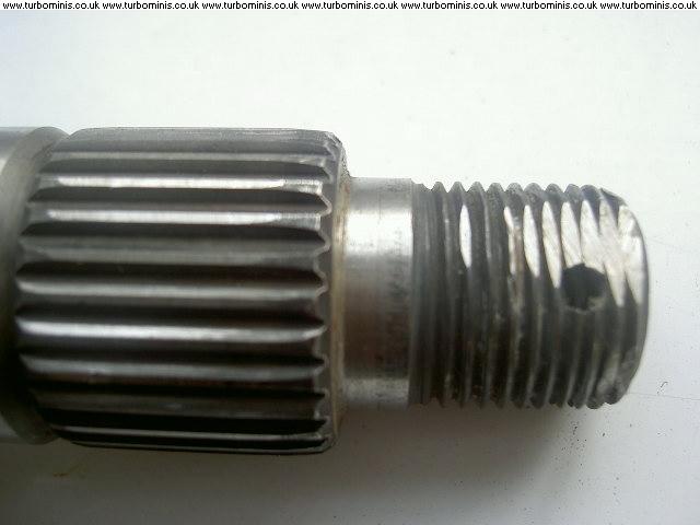

This CV JOINT any good...
http://www.turbominis.co.uk/_photos/random...os/718/4177.jpg
Cheers...
Shit Happen's
Technicaly no, but if the nut spins on freely and it torques up ok, use it at your own risk.
My personal feeling is i wouldnt use it, reason, its a high torque thread and under considerable stress. reducing thread contact weekens the joint.

Did you grind the castle nut off?
Bat
4559 Posts
Member #: 786
Bermingum
Been there done that. It usually cracks the nut when you torque it up, even after you dressed the CV threads :(

Ive had an impact gun taking one off and it just spun and chewed the thread.
Couldnt get the nut off as it was stuck in the groove. Bin me thinks *tongue*

I would bin it. I've been torquing mine up properly. Over or under tighten must lead to failure & fatigue. Its a weak link in the drive train.
On 19th Jan, 2010 wil_h said:
didnt one of JF's fail recently?
may be ok ....said may be ...
but i would not use it either
the nut may part company
i would us it say on a plant gearbox in a pit...lol but thats it!

file it under b mate, it may be ok but i would bin it.

Well i did't know it was like this till i looked at it.. my mate, well the guy i met little while ago who lives round the corner, who calls him self An engineer.
who has already messed few things up, must of done it. little while ago i couldn't get the nut off. so he took it and cut the nut off for me. didn't think of looking at the CV JOINT. but cant be assed to blame him... he already tryed to get the bearing out of the clutch casing, were u have to drill the 2 holes. that come out crap. so me buddie BENROSS is sorting it out for me :)
Makes a change to find someone who knows what there doing.
Anyway. this is from a 1275GT..
Has anyone got a sencond hand one for sale please :) guess ill place that in wanted.
Thanks for your advise lads :)

Think they are only £20-30
