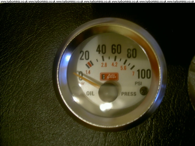

Also, i have one of these on me car.
Whats the idea of this..
Shit Happen's
Bat
4559 Posts
Member #: 786
Bermingum
Yes, just run a pipe from one to the other.
You'll need an oil temp gauge too *wink*

Markie_D
862 Posts
Member #: 1660
Formally Mini_Uk
London
So thats a oil pressure i have there.

You know the temps on the clocks..
One's for the fuel of course... and the other ones for the water temp isnt it ? coz in traffic that used to rise high..
Cheers..
Shit Happen's
You can tell ALOT from oil pressure, you will find that as the temp rises the pressure will drop, if it drops to stupidly low pressures then its a good indication that your oil is getting too hot. *wink*
iain
8506 Posts
Member #: 16
Near Lincoln
careful putting the sensor at the front t'd into the oil pressure gauge as there is no flow through there (if you dont have a turbo feed!) so its not representative of the temp.
Also i found in winter that the air through the grill altered the readings, with something to stop the sensor getting cold i had a lot more sensible reading.
Best place to put one in is in a mocal temp sender adaptor that only cost £15ish i think.
