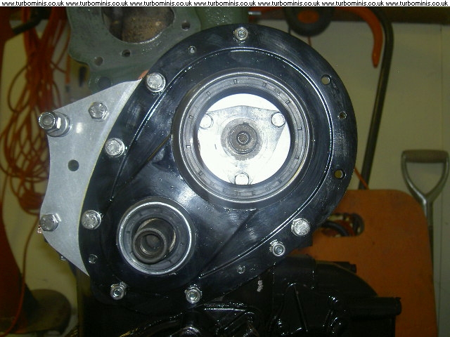

Can someone tell me what Ibf ft should these 2 bolts be please.
Cant seem to find the right torque im looking for in the haynes..
Not sure if it matters too much. but seeing this is my first time, i want to get it spot on, incase of leaks etc..
Thanks alot..

Just nip them up. You won't get any oil up there! The cove ones are more important.
Gavin :)
Oh right, yeah guess so, durr..
Thanks for answering my silly questions *wink*

You will have to take those bolts back out to fit the cover

not if the cover is A series, or if he is running a belt drive setup*tongue*

You running duplex as well?
You might have to take the csk holes a bit deeper. They look like theyre protruding a bit.

Id fit your crank pully before finaly tightening the cover bolts. It will center the seal. They have a tendancy to leak otherwise, and that is not so good on a belt drive set up

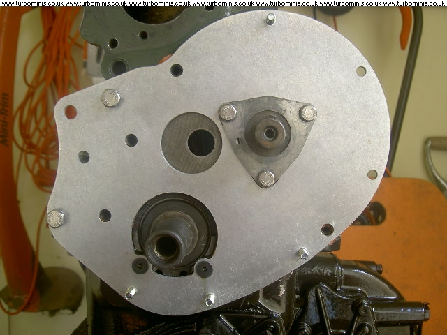

Got problem now.
One of them press fitted bolts on the plate is giving me jib.
The bottom one in the pic.
as i tighten the nut up, the bolt keeps turning round. it's tight a little though.
All the other's are fine.
Ive tryed to get something behind the bolt to press against it as i try to tighten the nut up.. but no joy.
I stuck the plate on using the gaket and wellseal of course. then left it over night. so its nice and sticky. so dont want to start taking the plate of now.
Would it still be ok not tighened up to the 5Ibf ft. ive packed it well with wellseal. ?
if not, any other solutions ?
And im running a belt drive setup
Cheers :)
Shit Happen's
Something is clearly amiss here.
Why is the stud turning if the nut hasn't even bottomed out?
These studs should never spin.
Ok, had another look - are those the nuts I provided? The only way a stud could spin is if the nut was cross-threaded (or the wrong one)and tonked up, or a nylock fitted?
One of the reasons why i send the plates with the nuts on them - it's so I know the threads are fine. They are a loose 'spin' fit onto the threads - you certainly shouldn't need a spanner / socket on them until they've bottomed out.
I am interested to see exactly what has happened here - so if you want to send me a PM, then that is fine. Alternativly - if you want to continue dealing with this on a public forum, that is also fine. I've no problem with that.
One final word though - If it's spinning, it'll always spin. I doubt it can be re-pressed in either as the alloy is formed into the stud - and if it's loose, then it has removed the material, and will not work.
All you could potentially do is to remove it and weld a 'tang' onto the back of the stud, and retain this as you spin the stud.
Again, though - I cannot understand how this has happend; but am interested to find out to see if this can be avoided in the future.
They will be fine for any duplex I've come across. Yes - They would look 'better' if the 'outer' faces of the screw head and plate were flush...
Reason they aren't 'deeper' hpwever, is because if the CS was deeper, then the end of the thread (the intersection between the taper and thread on the screw) would bottom out in the thread on the front main cap. If someone didn't realise this, they'd tighten up the screws - assume that they were nicely snugged - but in actual fact the plate wouldn't be compressing the gasket.
Easy solution (of course) is to counterdrill the 1/4" UNF holes in the cap by a few mm, or countersink them. But, it's easier for me to make it so the job is right, than to trust everyone else to realise and do something about it.

It looks to me like they are nyloc nuts?

Just about say the say Tom. We use press studs at work, they don't take too much effort to spin. Wouldn't use nylocs.
Dave supplied normal nuts with the plate in my picture.

The nuts are not nyloc, it has a spring washer behind it, (ill remover them) so it looks like a nyloc nut from the picture *tongue*
I was gonna chicken out and just PM dave lol so thought i may as well come clean and tell everyone what a wanker i am..
Anyway, i got the nut off, pain in the ass, but My own fault though.
yes dave, i used a different nut, same kind of nut, but stainless steel, as ive changed most things to stainless.
the others took the stainless nuts ok, just not that one... sooooo, i put your one on dave, and guess what, it worked *blush*

Did you try 1/4UNC stainless? If you did - it should have worked? Maybe the one nut you tried was incorrectly cut - or an M6 had got mixed up in there?
No worries about this - I was sure something would be amiss. I was ready to send another plate over but hey presto, no need!
If you'd be willing - I'd appreciate some pics of the plate being fitted up - and with the belt-drive (and all bolts) fitted. The first one (but without the arrows - lol) would be ideal for one! *wink*

Here's the plate with out the arrows *wink*
More will follow next week.
as im going back home for little while.
Cheers once again.
