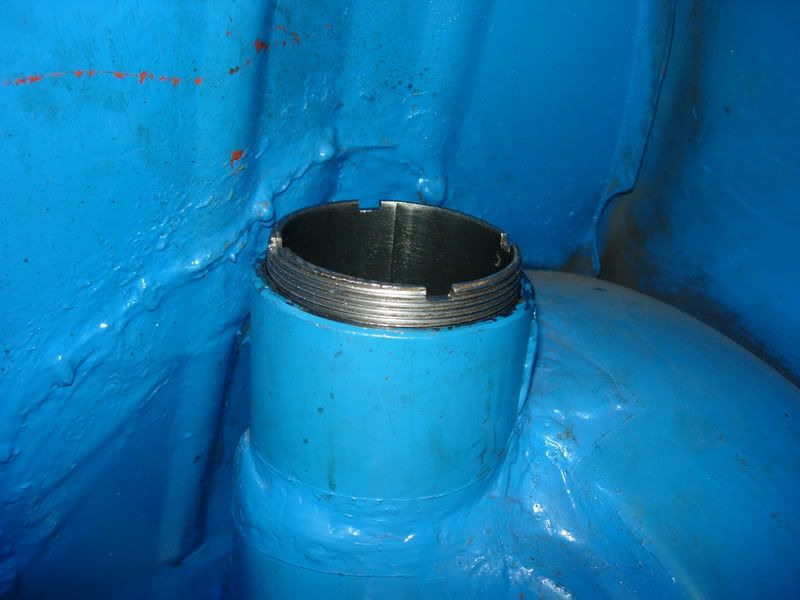

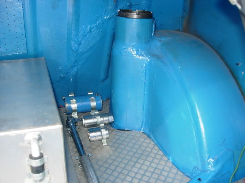

I agree with Paul, its all about how you set them up! Ive got em on both my minis and they can be very versatile and supper easy to adjust, spring weights for your application are important.
On my clubby you can adjust the height really easily by having some large threaded pipe welded in to strengthen the rear shock locations, just means more adjustment to get the set up I want*happy*
I think I have a pic ill post it if you want to have a look*happy*

yer a pic of that would be good mate.

hughesmarkie
232 Posts
Member #: 1197
Dublin Ireland
Here you are Josh, as requested
And heres one a bit further out so you get a bit of scale!
The blue socket sits into the top pipe and allows it to be adgusted using the power bar *happy*
regards, Mark
