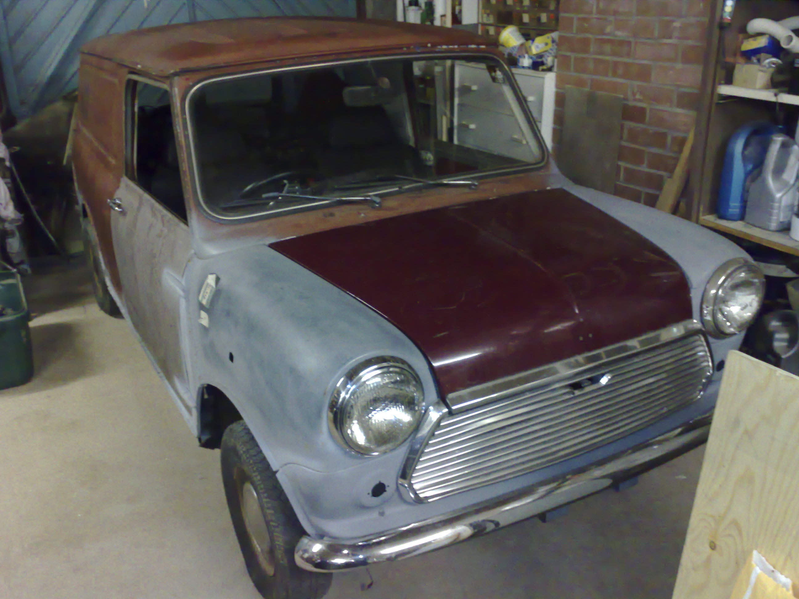

now then, i've just got my self a 1976 mini van and just started work on it and my plans were
mk1 grille and de-badged bonnet at the front
sports pack arches all around
un sure of the wheels yet, most likely 13s
suicide doors with a flase pannel inside to make a door card onto
custom steel dash full of smiths gauges (only problem is i can't seem to find a boost gauge in smiths)
classic buckets
smart wooden floor in the back
single piece back door opening like a tail gate with internal hinges
AND a nice little turbo engine
i'm after a fast BUT reliable turbo build, some thing around 130 - 150bhp if possible maybe out of a 1293, i'm not over keen on the idea of a largely over bored turbo, i've heard bad stories of them not lasting long.
i've got a intercooler of a s2 rs turbo as well i'd like to use.
just wondering if any one could give me any advise on the engine build, thanks
1976 mini van soon to be turbo'd (it doesn't have an engine at all at the moment)
