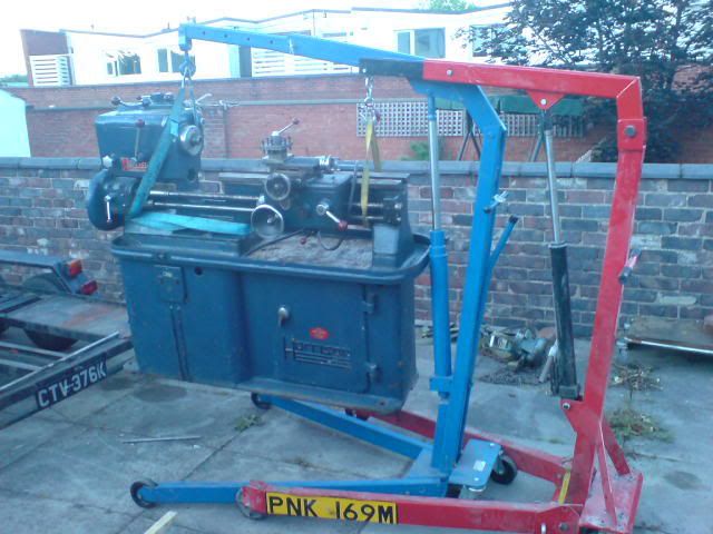

Hi There, I've bought myself a lathe, no the problem is getting it home. The weight of it is approx 650kgs, any tips on how to get it on and off the trailer. Do you think 6 people could lift it?

Large engine crane?
Jack it up and support on sturdy wood and axle stands then drive trailer out from underneath?
6 people might lift it, but carrying and maneouvering it would be a whole different ball game!

Me and my mate lifted his lathe off a trailer with 2 engine cranes, then dropped it onto poles, and then rolled it along, like the egyptians!

jim do you not now any body with a transit hiab, some tyre companys and engineerig companys who make truck springs, or even a tail lift on transit or 7,500 truck
the problem is pete there is no head room in the garage where it currently is, ot my garage which it it's going into. my guess is about 8ft max
With enough people, i reckon you could do it
Particularly with the application of weetabix/spinach/steriods
and stella!
The last time I saw one of these moved, the guy enlisted the help of the local mini-skip guy. He was able to lift the unit off the floor from inside the door and then lift it onto the back of the truck once he was outside. As for getting it off at the other end, he repeated the process but dropped it onto poles so it could be slid into its final position. £50 in his back pocket and he was happy.

Pallet truck it

you could use soaped up timber and let it slide into the garage from the trailer,not for the faint hearted:cool:
Rite if it weighes 650 kg how much does your mini weigh (no more i would of thaught) try and pick that up. ye the rear no probs but fronts a different ball game . Anyway think the pallet truck idea is best with engine crane to get on an off trailer, either way whatever you do its going to be fun . He He He

Hi i just brought my new mill home got it off the trailer using some nock up scafolding some 7x2" timber and the chain block waighs best part of 1200Kg.

dont attemt to lift it jim even with many peeps its too small a heavy weight & top heavy and will go over an kill someone.......... god forbid
remove the headset if you can and maybe then

Strip down the lathe, remove the bed from the base and do it with an engine crane, takes a while but you will still have your back intact!! which is better? more time moving it in sections, or a couple of weeks off work because you have pulled your back?
