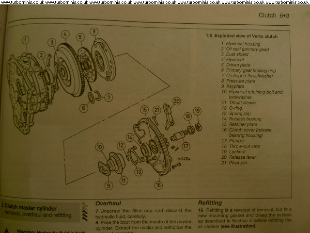

When i took my clutch apart a while back.
I did not notice these 2 (NUMBER 13 AND NUMBER 15 in the picture)
Do i need these or not ?
Cheers.

Possibly, as they hold the release bearing in!
Unless you have the old type where the bearing is an interference fit on the shaft...

Must be the old type then.
As there is an O ring that hold's the bearing on to the plunger.
Cheers mate.
