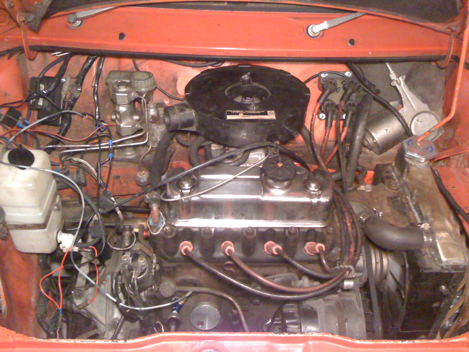

miniboo
348 Posts
Member #: 2253
Las Vegas, Brit in the States
Here is my setup just before i pulled the engine out.
