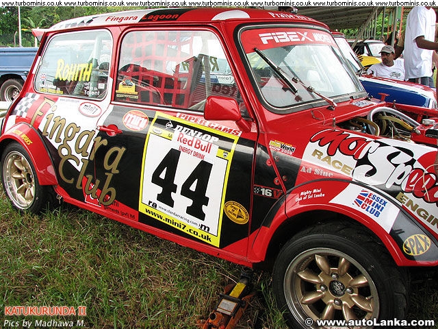

Found these pics of Rohith de Silva's (out of sri-lanka I believe) mini...

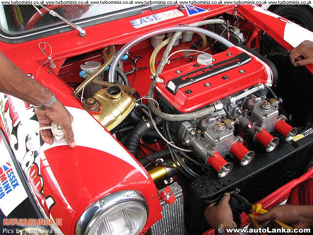

Strange thing is - it says 16v on the A-panels, but it looks - in every way - like a K100 8v unit.
Is this one that we say a video of I wonder???

Well the cam cover is pure 8v - the true giveaway you can't see clearly (I haven't zoomed the pics yet)is if the injector positions are in the head. The 8v has them after the inlet manifold in the head the 16v has them in the manifold. Hence if its an 8v these would have been plugged/welded.

It's a 970(999) 8V. I know for a fact.
I don't see how that can be a 16v as the bolts which hold the cam cover on are in the wrong place. the 16v ones should be staggered shouldn't they?

they are staggered, its the 16v ones that are in line.
easy to see in this thread.
http://www.turbominis.co.uk/forums/index.php?p=vt&tid=137009
sorry mate, thats what I meant.

Vegard is slightly wrong - engine was stripped and found to be 1100cc and car was allegedly disqualified as was entered in under 1000cc class!
On 5th Sep, 2011 Vegard said:
Scruffy, how you feeling now? all better??
Did the owner know it was 1100cc? or did he think he had a sub 1000cc.

That carbon-fibre plug cover (not cam cover, but plug cover) looks kinda nice...

i just dont get the 16v claim,
it blatantly isnt to anyone that knows, unless morspeed have gone to the hassle of welding bosses into 16v heads so they accept 8v covers, which i doubt.

Still a mystery then - of course we don't know if it really was accidentally built as a 1050, intentionally built as a 1050 to race illegally, or as a 999, and then modified later to gain an edge...
I'd have thought a sweet K100 conversion would have worked more than well enough - especially if efi had been used - to have won any race that a 5-porter would have been competing against.
All very strange, and I suspect - nay KNOW - that the truth will never come out.

8v covers just don`t fit onto a 16v head,,, (& vise-versa) way too much stuff around to even think about bothering to "try" too either
they`re both just so totally different in the castings with cam cover bolt positions, the base of the covers & the tops of the heads are totally different & just won`t fit.
Heaps of people "talk" about a twinky & use an "in-general" term of 16v when talking about them, silly mistake & easy made,,, but "IF" they were intentionally fibbing about it being a 970 & it ends up an 1100 then why confuse the issue even more by saying it`s a 16v when it`s clearly an 8v

I've just been thinking about this... And it annoys me a little - becuase if this had been posted as being a little 1050 screamer, using the 8v head instead of the 16v for whatever reason (had to be 8 valves for the class, for example), then this would have been uber cool - and praise would have come from many corners - myself for one.
This proves what the outfit in coalville is capable of - some damn good stuff if we're all honest; who can say they would happily have such an engine in a spare mini for a trackday razz or whatever?
Instead, the truth gets 'expanded' upon - embelished if you will, and next thing I (we?) are pointing fingers and laughing, when we could (should?) be pointing and clapping.
That is what gets me about this particular builder. If he hired a dolly to answer the phones, a couple more McJob guys to do the mundane (read difficult to get wrong) stuff like degrease engines and skim heads, leaving the man with the reputation to do the stuff that really matters, this would be the place where stuff could really happen.
The proof is in the first two pictures in this post I feel.
