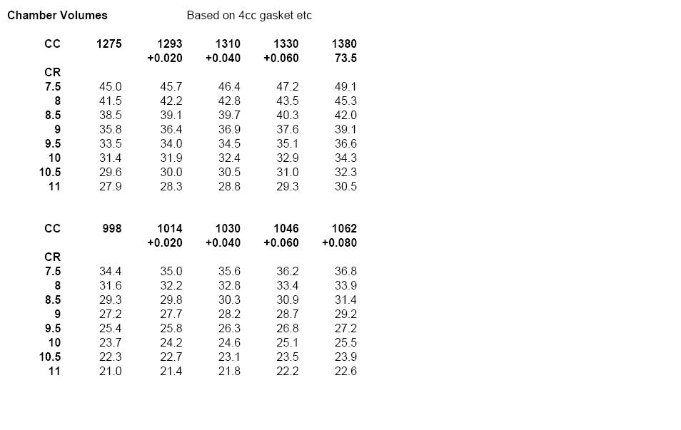

Found this compression chart while I was looking too, just thought i'd post it again
Matt

If my calculations are right to run 8.3:1 I will need 14cc pistons(accralite) and 24.5cc head or 23cc head for 8.6:1
