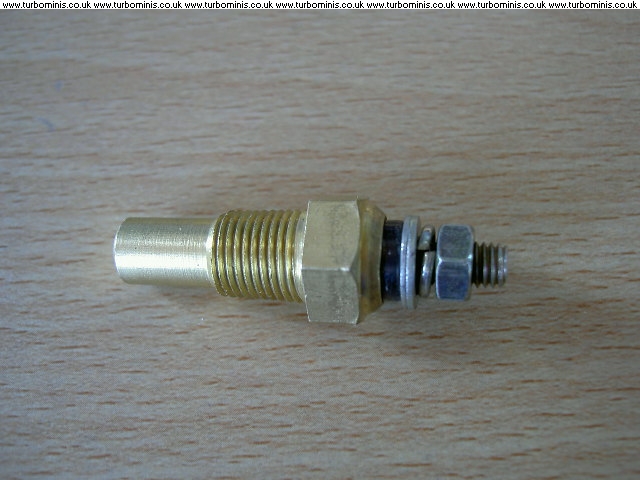

But i just come across my oil temperature gauge.
But where do i place this temperature gauge sensor ? *oh well*

i made an adaptor and put it in the sump plug hole but i guess its not ideal

you can either drill and tap your sump, or if your lazy like me you can use a sandwich that goes between your oil filter and housing, that has 4 holes for whatever you may need.

or just fit a later type sump plug with one already fitted

that would work but you wont have the magnet on the end, i have just fitted a inline one to the filter, ms used to sell the mocal unit

looks like a good bet to me although i don't know what the mini oil filter thread is.
also I'm guessing the raid adaptor has a couple of different sensor threads.
the other thing that might be doable is to thread the oil releif valve cover to take the sensor like on MPI's
In fact i've just bought one of those ebay sandwich plates, i'm going to use it for the turbo oil feed and oil temp gauge.
Also the mini is the same filter thread as an escort as I have used the water to oil coolers from xr3i's

thats the sandwich thingy! yes it is 3/4 unf.

It say's (fits in between the oil filter and engine block)
I thought it goes between the oil filter and housing?
Cheers anyway :)

but you will need something like a ford sender as the minis are to big a thread

Got mine today, just screws in between the housing and oil filter.
Works a treat :)
