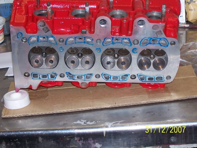

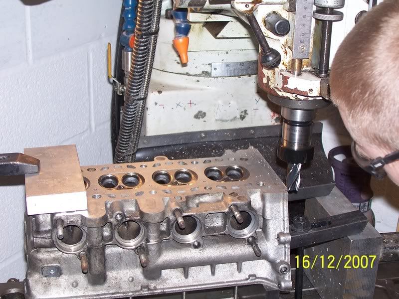

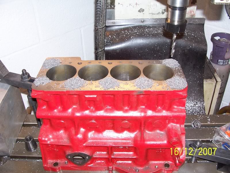

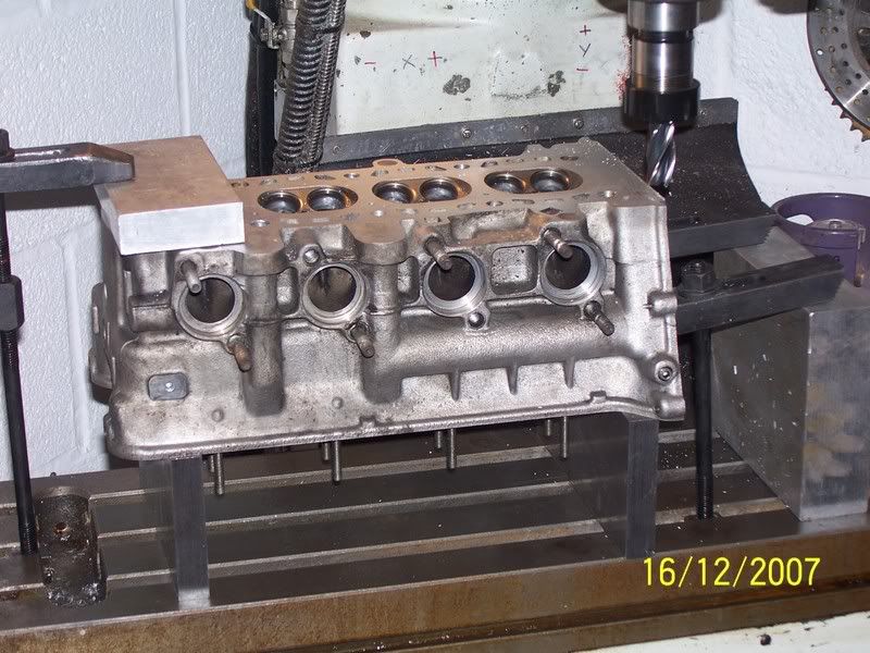

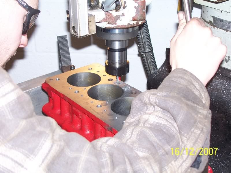

Hi all well so far ive had the block bored to 73.5, ive welded in the blanking plates had both the head and block skimed, ive drilled the block for the new stud holes and water ways and am now in the process of working out the valve cutouts, took posetion of a Specialist components K head kit, which i must say is a well engineered kit for the price only going to be N/A for now then turbo later on hoping to have it up and running for minis vs beetles at york.

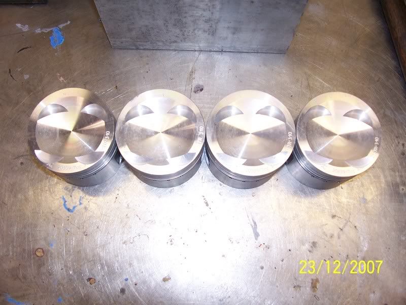

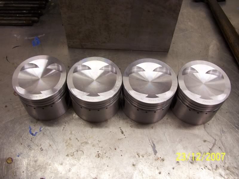

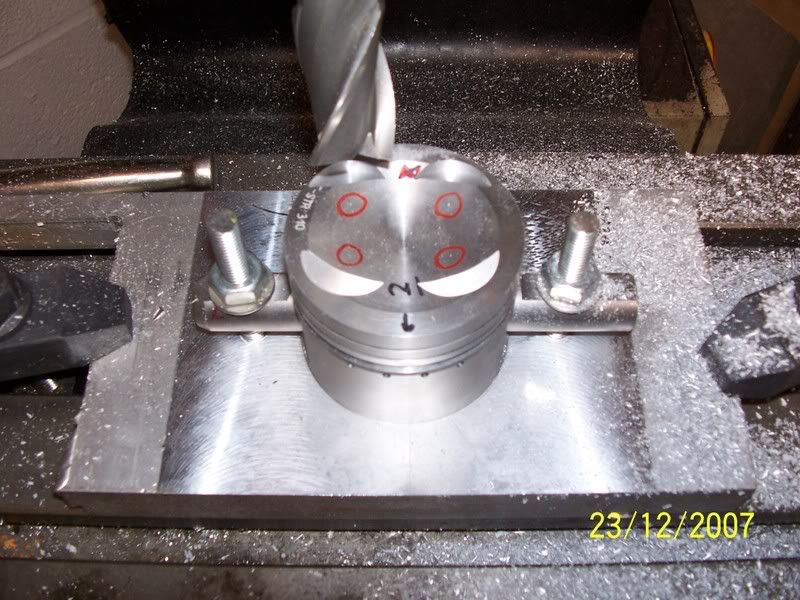

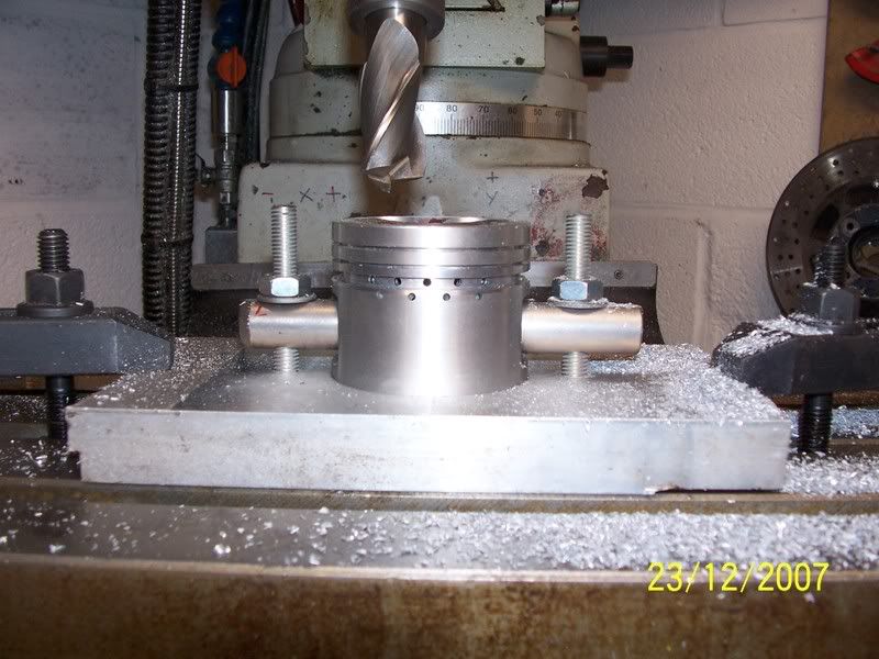

just an update did a dry build and milled the pistons today,

quik update today will consist of trying to get pistons on rods and a lot of cleaning ready for the build to comense. after dry building the engine last night it is posible to cut out enough piston so in the event of a cam belt failure or it coming off i will have no bent valves, in my engine this equates to 5.5mm inlet pocket and 5mm for the exhaust pocket, thought it might aswell be bullet proof love that straight cut scream!!!

Nice work - I always run 5mm cut outs in "normal" cammed engines - looking good - you'll have it running before end of Jan!

Coming along nicely. What size dish are your pistons? https://www.facebook.com/pages/Fusion-Fabri..._homepage_panel

Hi block rods and pistons are all one now just on cleaning the box out as it contains the remains of my old piston no damage though which is luky. The dish in the pistons was 7cc its now 10cc which leaves me with 10.65:1 comp was hoping for 11:1 but thats close enough cant waight to hear it fire up some more pics shortly. love that straight cut scream!!!

27th Dec, 2007 at 03:49:47pm
Nice shiney clean ears you have there, but maybe those goggles should have actually been covering your eyes while you were milling that alloy www.miniman.com.au
![]() 368 Posts Member #: 362 Senior Member durham area |
27th Dec, 2007 at 07:05:46pm
Ha ha yes put them on when i started cutting i cant see sh!t out off them for lining up should realy hatch a new pair out. love that straight cut scream!!!

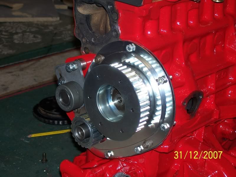

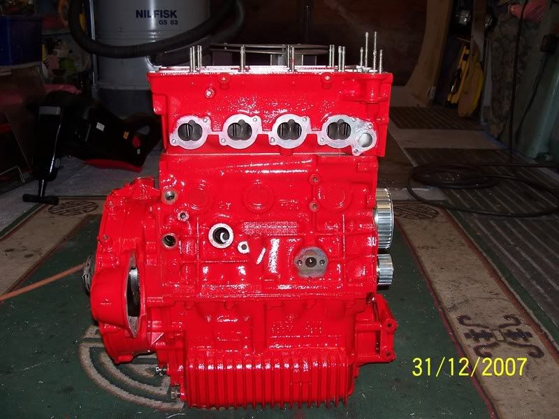

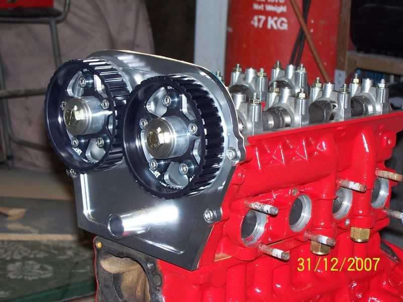

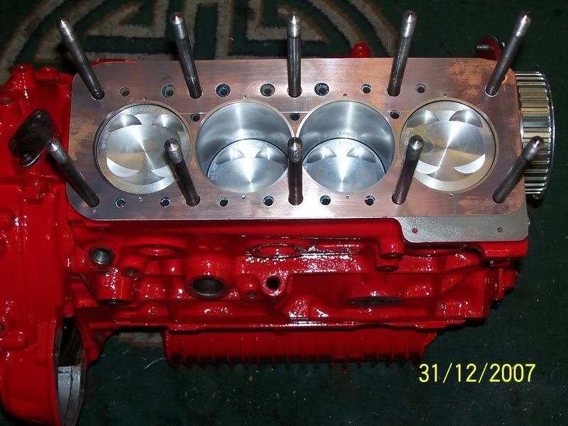

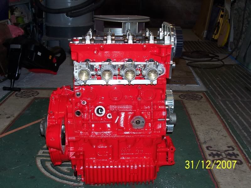

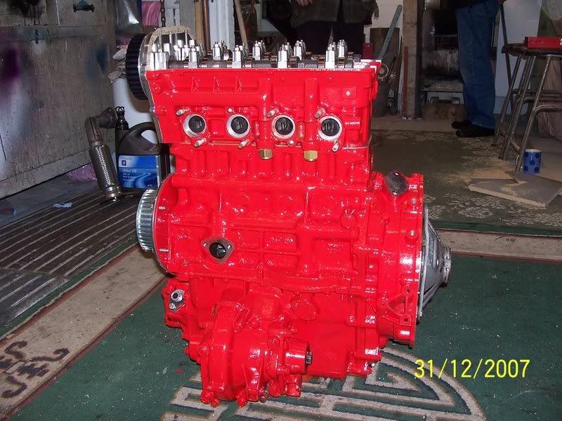

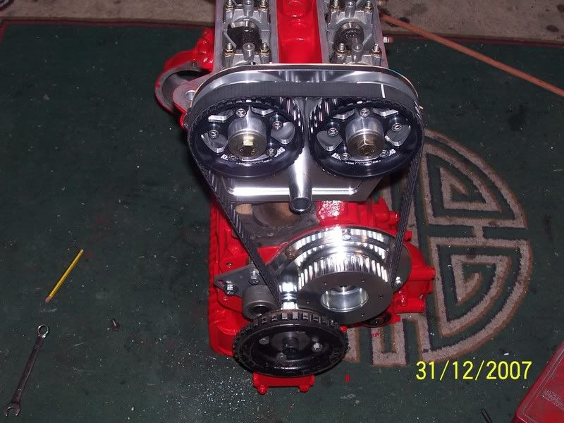

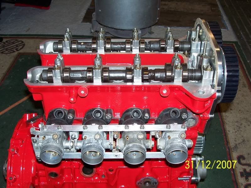

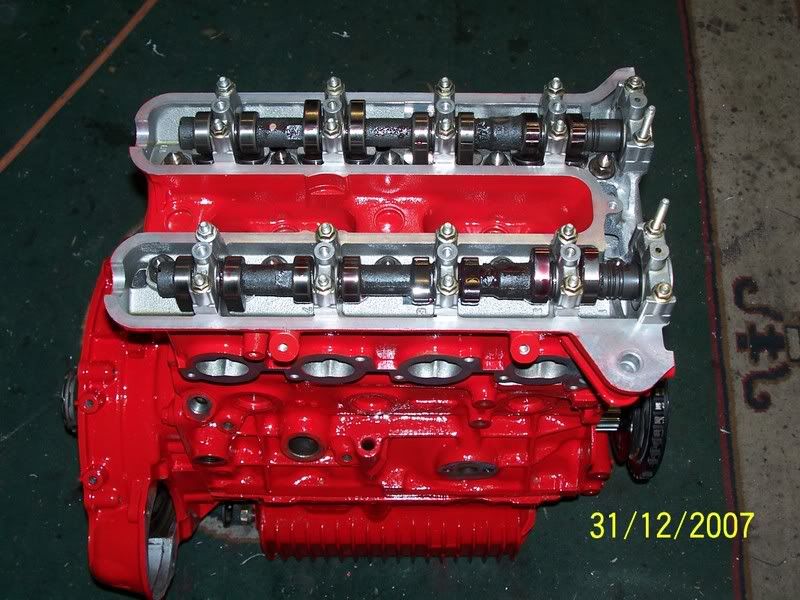

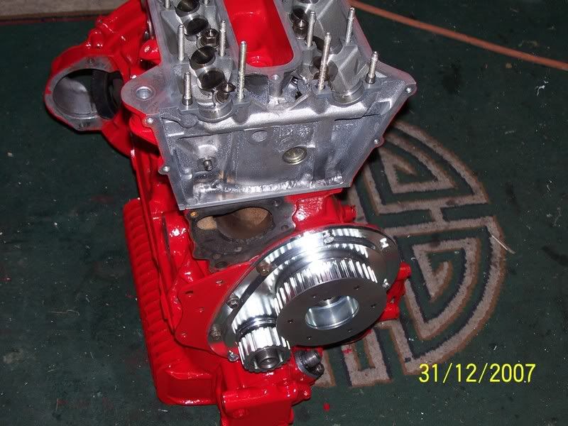

31st Dec, 2007 at 08:29:55pm
more updated pictures for your viewing nearly there love that straight cut scream!!!
31st Dec, 2007 at 08:48:34pm
Excelent progress!
1425 Posts Member #: 690 Post Whore Norfolk |
31st Dec, 2007 at 08:57:05pm
Brilliant work - sunglasses for that colour mind!!
