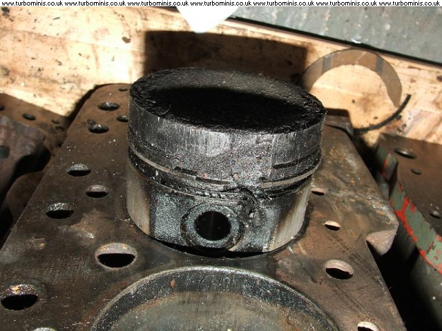

intresting pic here , though not too clear, sadley *frown*
its from a motor a tore down for a customer some months back
just shows you how destructive detonation can be
although this if far from the worst one i have seen *laughing*
Edited by BENROSS on 8th Jan, 2008.
I deffo see a pattern emerging with relation to the damage.
Most of the time the damage is where there is no coolant jacket to speak of, where the bores are 'siamesed'
what would you say?

Makes sense, that would be the hotter part of the bore.

and right above the exhaust valve

on examination the two inner bores have taken most of the punishment
pays to go a tad rich on the mixture to cool the piston crowns

Ive got pistons exactly like that in one of my blocks. However supposedly it still ran before.

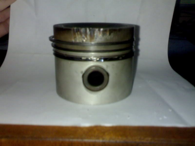

I have this one in the garage, mm, nicely bent oil ring
WTF! worst i have seen sprocket
what was the history of the motor ?
any other pics Gents ?
It was a standard MPi. My guess is that the driver proceded to use the car when the cam sensor had failed, resulting in non sequential injection and on the MPi, thats bad!! I have seen melted cats and all sorts of crazy stuff. The rings are slack as Norra Batty's stockings, the pistons litteraly fell out the bore. I also recon it was a high mileager with little care. Bores are shinier than a highly polished mirror. Its them Rover long term oil changes *laughing*
I think it was pre igntion rather than detonation that did this damage though
It had little chance *laughing*
Its them Rover long term oil changes ........LMAO!!!
