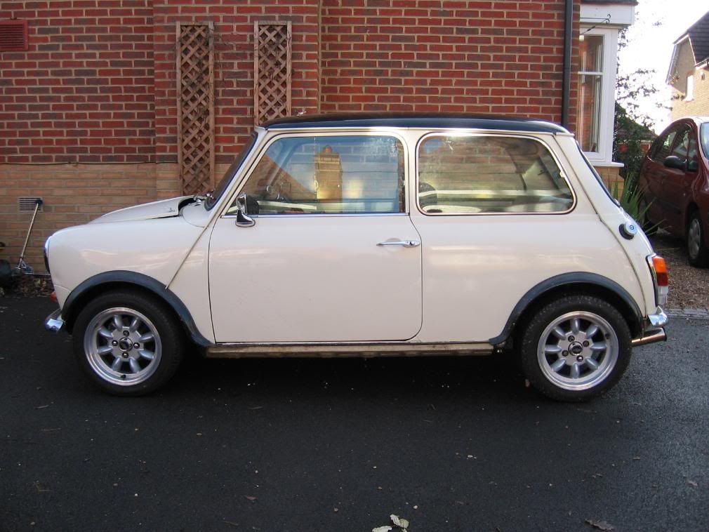

About time I got some pictures up so here goes. Hope this works!

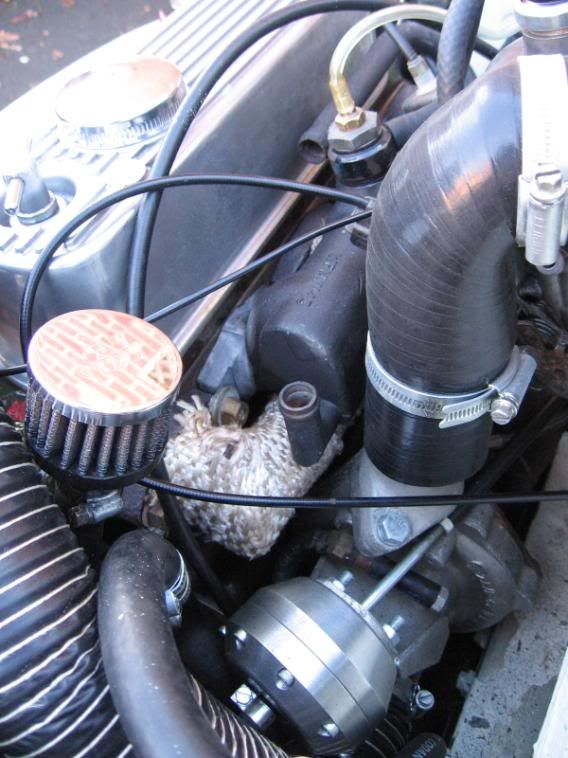

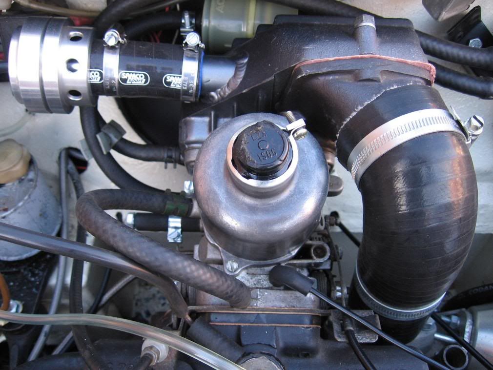

I included the last picture as I am not sure which ic to go with, either the RST or the Lancia Delta. Any recommendations??
Hope you like!
Rich

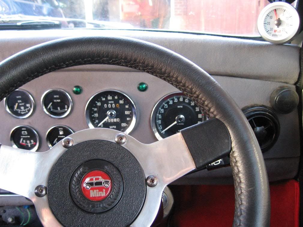

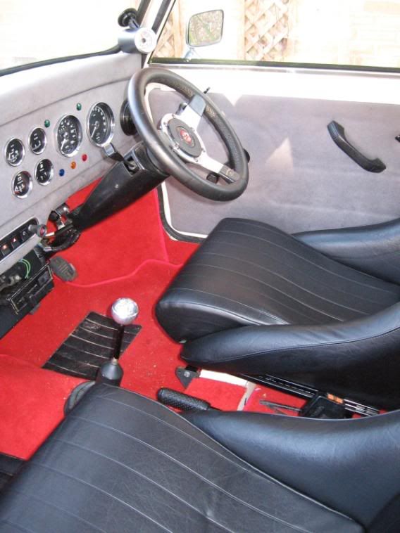

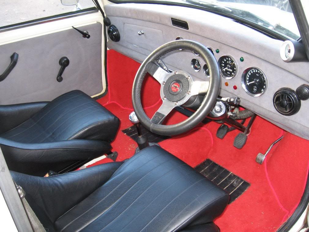

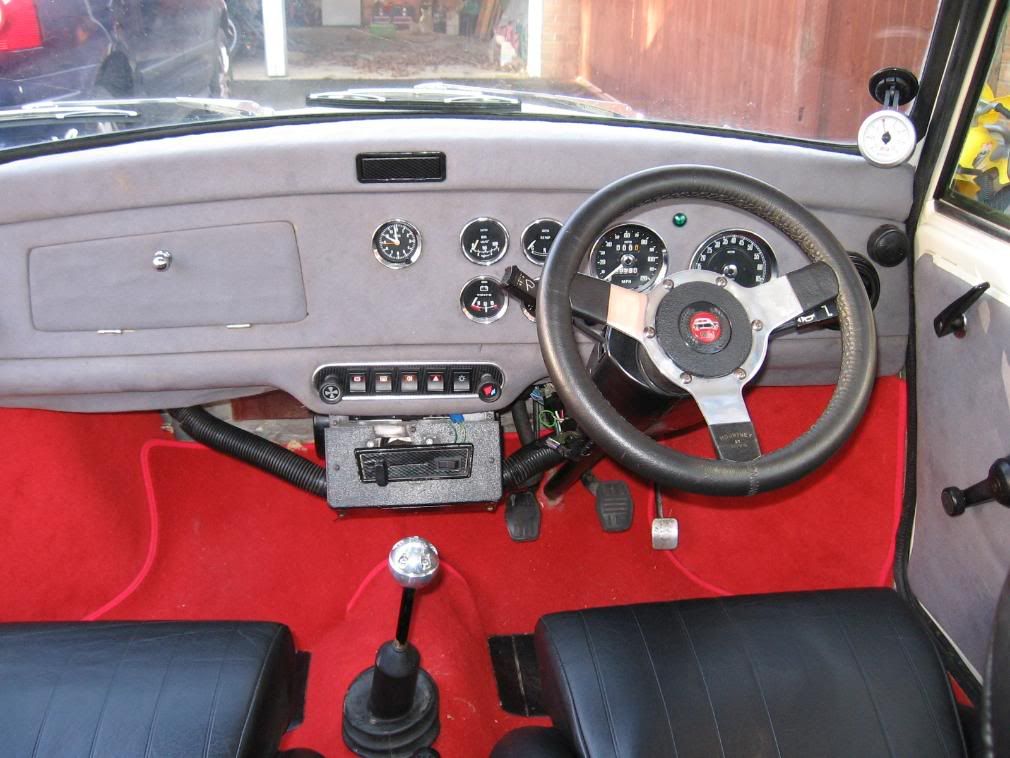

Really like the dash. Looking good *happy*

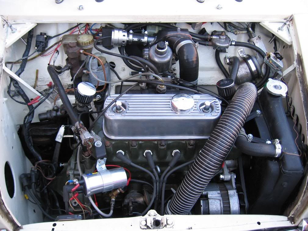

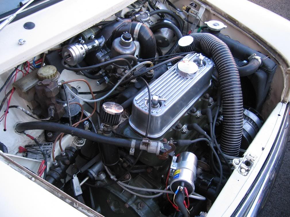

Thought I'd add inventory too:
Reconditioned A+ gearbox with straight cut transfer gear & twin cross pin diff
Lightened/balanced flywheel
Lightened clutch back plate
Orange diaphragm
MED lightened/balanced crankshaft
1310cc A+ block
+40 AE Turbo pistons with machined tops (can't remember how much removed)
Avonbar Phase 2 cam
Avonbar high boost head with 37mm inlets, std 29mm exh
1.5 high lift rocker assembly
Std MK1 dizzy
Std Metro Garrett T3
Avonbar adjustable actuator
Group A dump valve
Green Cone Filter
Minispares large 2 core radiator, no mechanical fan
Pacet thermostatically controlled electric fan
Adjusta ride suspension front & back
Adjustable Spax all round
Wood & Pickett s/s exhaust system
Standard Metro front vented discs with 4 pot calipers & braided hoses
Standard rear brakes with braided hoses
6x13 Superlites with Yoko A008
super!
Looking good! Very tidy indeed!

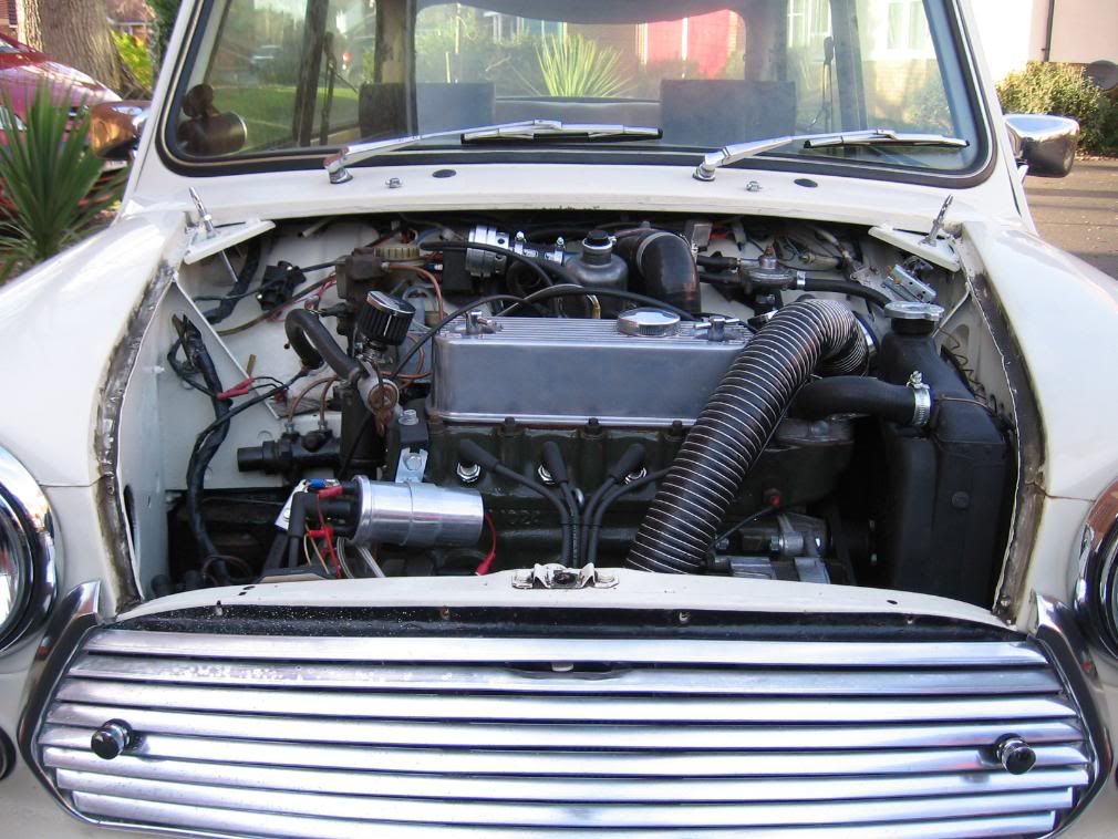

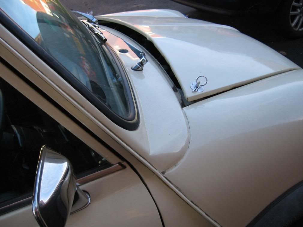

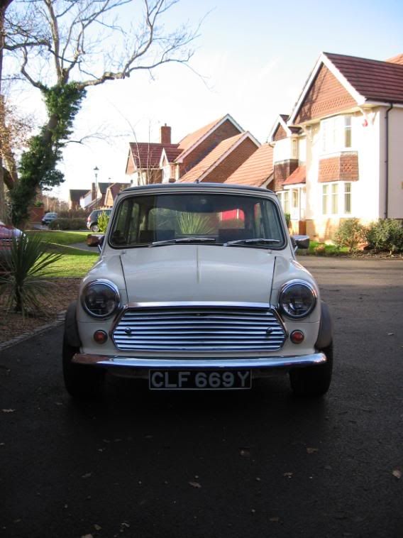

One thing though. Your bonnet doesn't seem to fit properly along the scuttle. (I'm starting to sound like Vegard!)
If you can get the Lancia one in, go for it. Nic has prooved that these work well.

very nice and tidy
My build thread..
very very nice
I used to use the lancia one, dave jon and several others have used the rs turbo one
The rs is probably easier to fit as its a bit smaller, see which one offers you the best solution

Very tidy car. Liking the dash and that engine bay looks so tidy and neat!!

love the dash - very tidy looking car

the dash is very neat. lovely clean lines on that car, very tidy and uncluttered
4641 Posts
Lovely, tidy, clean looking motor. :)
Nice!
Tidy but not to perfect so you won't be afraid to drive it.
If it were mine, (which it isn't so feel free to ignore this lol)
I would
either use the bigger intercooler, or flog them and get a cossie one.

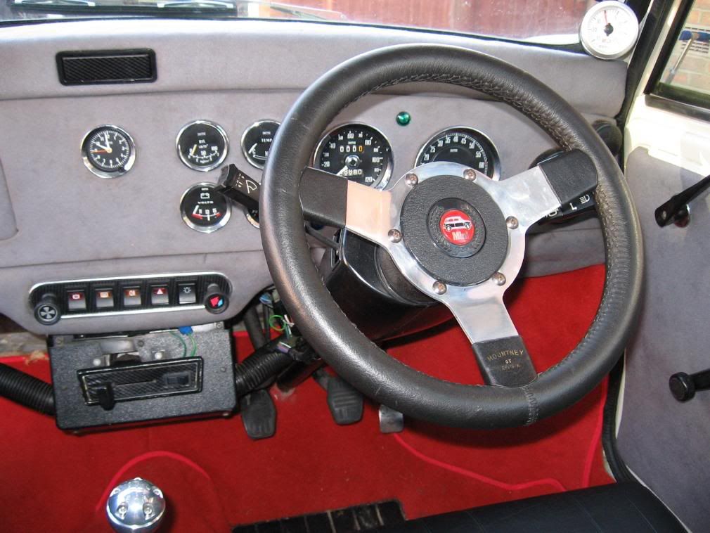

the steering wheel looks a bit small to me (might just be the pic) so i'd Get a bigger one (13")
Fit boost and lamda gauges.
ditch the dizzy and get megajolt on there.
Oh and get a new daspot plunger!!
*wink*

I thought the steering wheel looked quite big.
Engine sounds a good spec as well what kindve bhp you got or havent you got it rolling roaded yet?

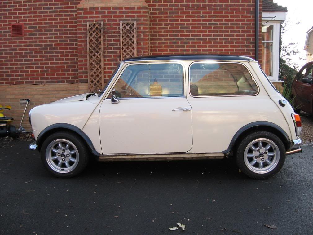

I love the colour, I know this is gonna sound NERDY but what is the colour actually called
Leonard
368 Posts
Member #: 806
Cirencester, Gloucestershire
colour looks like old english white to me
Turbo Rich
158 Posts
Member #: 551
Ashington W.Sussex
Thanks guys!
Colour is Old English White but I think it's now cold Arum White or something like that.
I like the small steering wheel, gives real street kart feel!
As mentioned, next tasks are fitting intercooler, lowering ride height slightly, sorting out headlining and yes once I've had a bit of fun with it, I will go with Megajolt.
Also, will be booking rolling road soon! However, I'm well pleased with the engine as it's only running 5psi of boost at the moment whilst I'm running it in but it still goes like a raped monkey! My previous daily runner was an Impreza WRX and I'd say the acceleration to 60 is almost comparable. Was hoping to run 8-10psi but I don't think I need to. Well at the moment anyway.

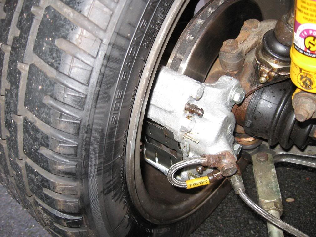

Is that brake fluid on the inside of that tyre? *surprised*
