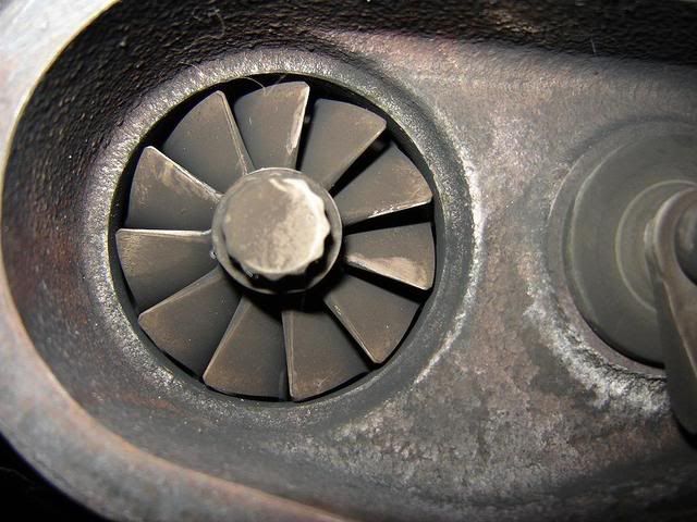

This is the turbine wheel in question.
Steel or Ceramic?
Warning:Stig in Training
that looks like my one of my std metro t3s to me...
not ceramic.

tommyb
81 Posts
Member #: 934
halifax, west yorks
heres pic of a garrett ceramic turbine from a skyline for comparison you can see the 12 point 'nut' which isn't a nut and is actually part of the wheel itself
That is a usefull reference... Cheers!
