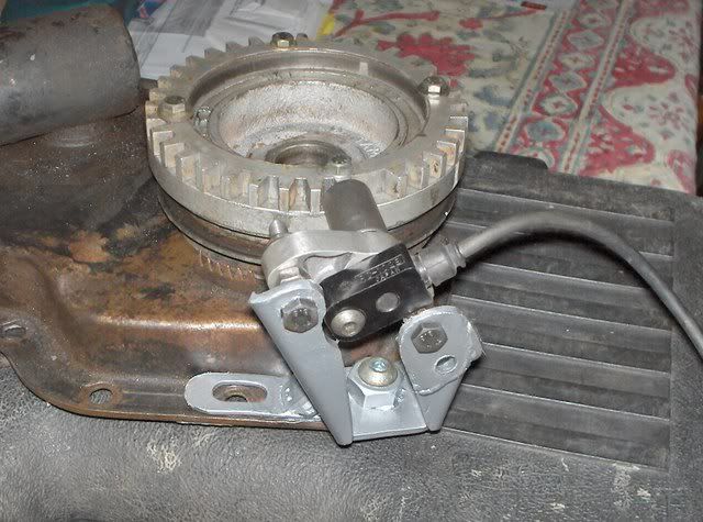

ROB1N
134 Posts
Member #: 664
South Wales (chepstow)
Here's it is painted
And heres the crank sensor holder i knocked up this morning its a bit rough but there we go ,it works though.
looks good enough to me *happy* what did you use to hold the trigger wheel to the pully in the end?
i was thinking a possible interference fit would work well, similar how ring gears used to be held on i believe or am i making that up?
ROB1N
134 Posts
Member #: 664
Yep the ring-gear method works well, once i machined the standard pulley and then i lightly trued up the trigger wheel .
you could use a grub screw to fix the outer ring to the damper, then you can loosen it and make minute adjustment to get the sensor exactly 90 btmtatdc (before the missing tooth at top dead centre)
do it like adjustable cam pulleys. a very good idea.
