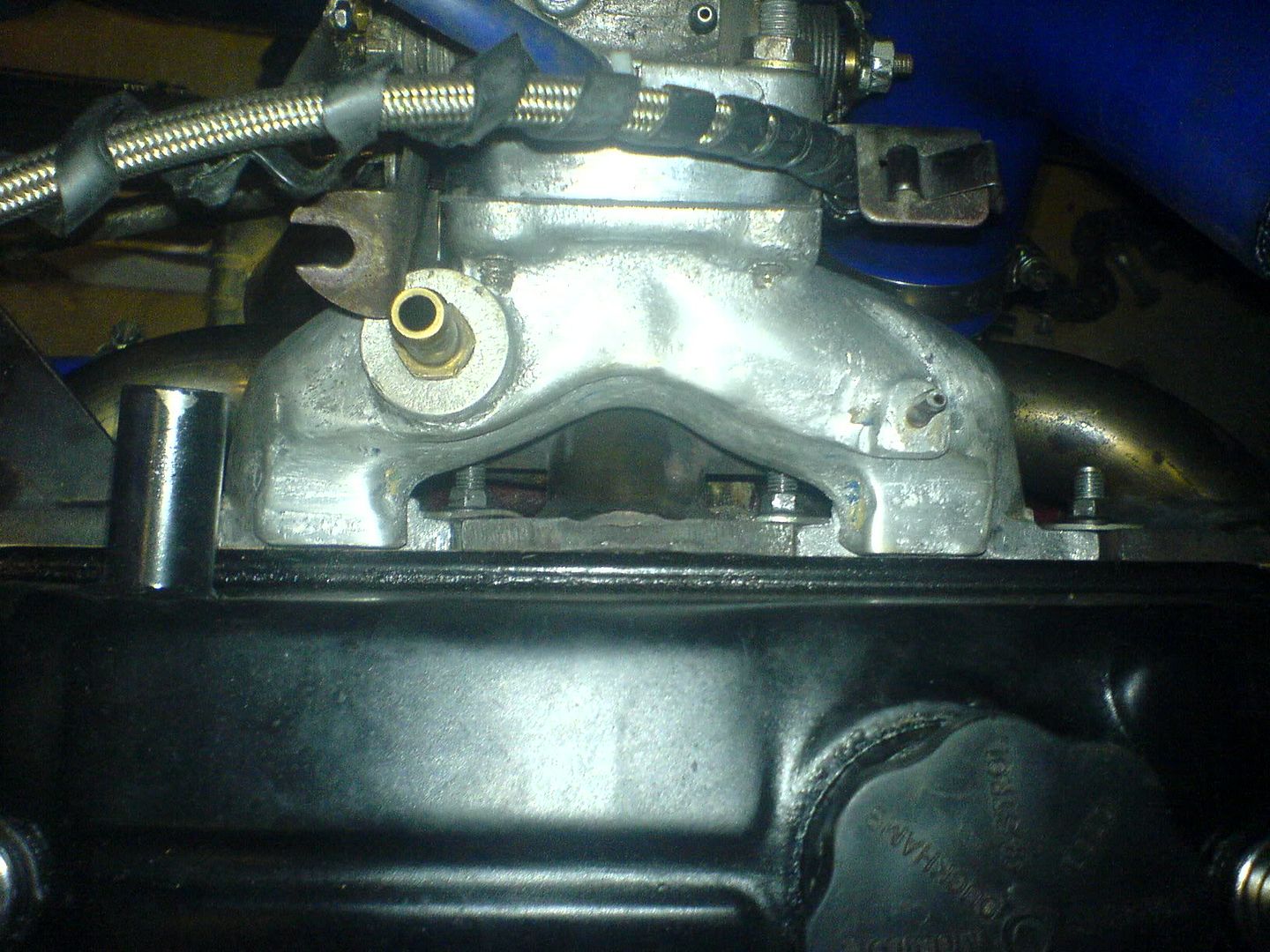

Right ive got some pics
thanks to my waste of an afternoon trimming down my inlet manifold you can see the nuts from this angle:

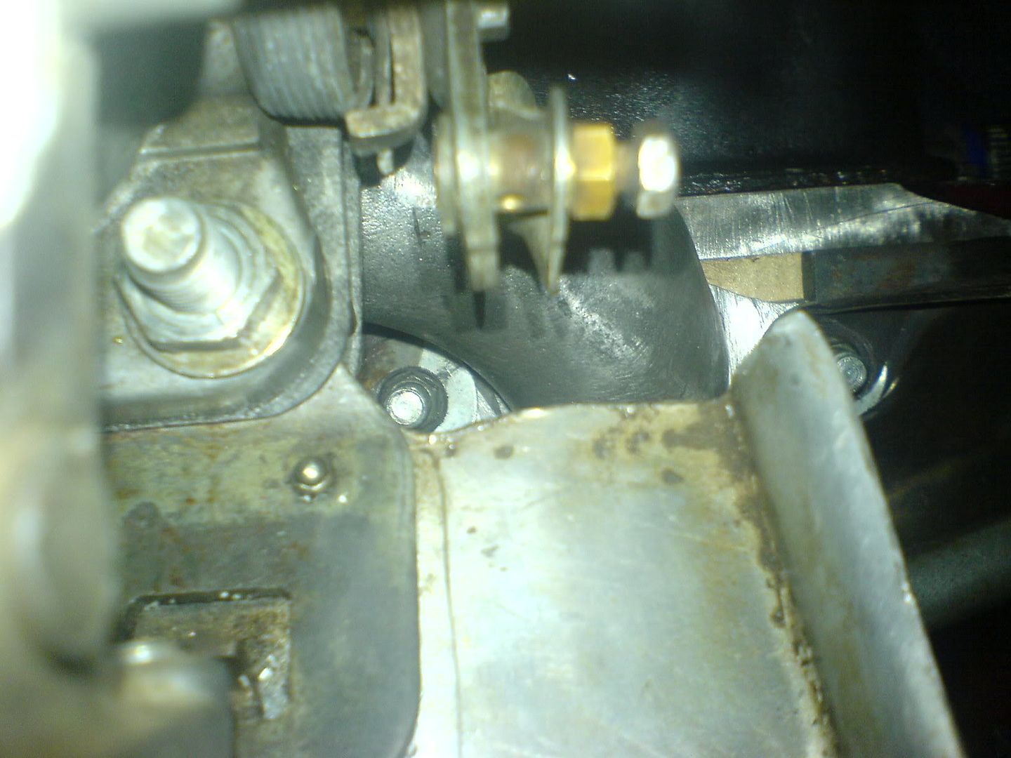

And this is what the awkward ones in the middle look like when looking near the carb, perhaps my dodgy heatshield helps here?
Its not the ones on the centre branch I can't do, its the ones on the outside of the inlet flanges.
Cheers for the photo though, My nuts are not like that. And my manifold id much closer to the studs on the outside of the flange.
nic,im glad you've finally got your nuts out for everybody to see.
Ahh those ones
Thinking about it, i think i normally start them off with the manifold half on, then push it on a bit more, put the rest on, and then complete the tightening process
