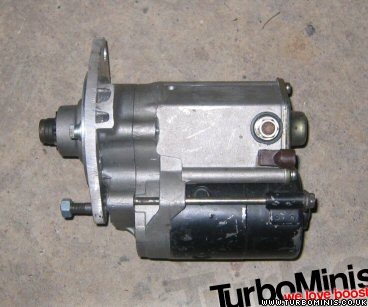

Wil in comparison to a pre verto starter do they stick out toward the front any further??
I'll try and get some photos later. As I say I've not fitted it yet.
And no, it sticks out less to the front.
Some photos. You can see that a stud has been put in so it can be bolted up from the other side, this stud will fit straight through the existing threaded hole.
I could be mounted either way up, but I'm planning on having the contact at the front.

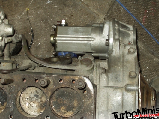

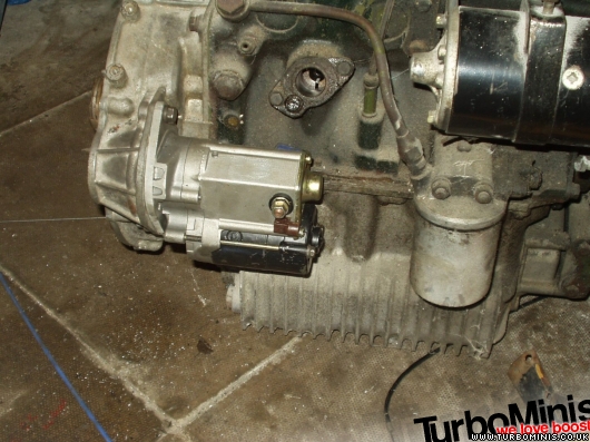

A few pictures of the starter on an engine

They are OEM starters with the ends machined to fit the mini.
Ben H
3329 Posts
Member #: 184
Melton Mowbray, Pie Country
They are basically of Japanese cars (I don't know the details). They are then machined and a new adapter plate added to fit the Mini, although in theory they can be made to fit most cars.
http://www.twin-turbo.co.uk
